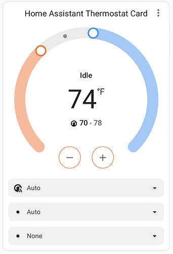

I’m unsure how to change the icons for the preset_modes when adding features to the new thermostat cards. As you can see from the screenshot, two of the presets (off and Prog1) show as dots only rather than a specific icon. Is this something one can change?
It’s not possible for now but integration will be able to provide icons for custom presets in a future release. It wasn’t ready for this release.
As a quick fix, you can use the dropdown style for now.

Hi Paul, any updates on ability to change/add icons now, or at least ability to have title for dropdown (as there are multiple “auto” possibilities with two dropdowns). Icon mode with no icons results in empty bullets!
At least this view gives heading/context as to what each selection is for. Maybe this is something I need to accomplish via card_mod?
Hi :wave: What integration are you using for your thermostat. It’s up to the integration to add icons for presets and fan modes.
