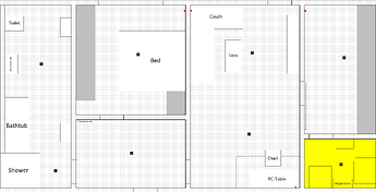

I have 5 rooms, two of tham have 2 lights (bathroom and living room), the rest have 1. I want to have 2 motion sensors, one in hallway and one in the living room. the light sensor is also in the living room.

I ended up choosing philips hue for all rooms but the bathroom. i want to use two “Yeelight Arwen 550S” in the bathroom. The living room and bedroom should get “Philips Hue White and Color Ambiance Infuse L”. The hallway and kitchen “Philips Hue White and Color Ambiance Infuse M”.
As sensors i want to take the philips hue indoor motion sensor that also has a light sensor integrated.
And of course a Philips Bridge.
As you see most of it is from Philips hue, except for 2 lamps, which led me to believe i need something to connect all that together → HA´. I chose the home assistant green for that, as it should suffice, but im not sure.
