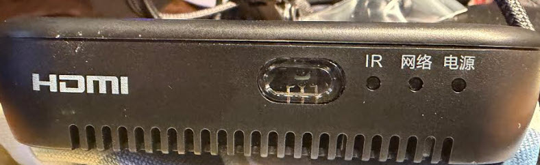

Last question: I see an IR light on the HA box does it use Infrared? i.e. do I need the box not in my video rack but across the room pointed to the video rack and its components?

At the very least tell us which box you’re referring to & which IR light.
None of the officially supported hardware has built in IR support AFAIK. If you’re dealing with those repurposed android boxes from a random supplier, I suggest you get in touch with them & ask.

Yeahh, that seems to be an ancient repurposed android box on which they slapped some version of HA (probably Core version, which is no longer officially supported).
I doubt you can do anything with the IR, at least not in HA directly.
