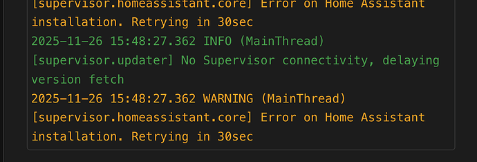

I’m a brand new user. I literally just built a Raspberry Pi 5 and had Home Assistant installed on its m.2 SSD. It appeared to build as expected and it eventually dropped me at the screen telling me my URL. But when I go to connect via my iPhone app, it sends me to the “Preparing Home Assistant” page with “This may take 20 minutes or more” underneath. When I click “Show Details,” I’m seeing nothing but errors, primarily these:
(MainThread)
[supervisor.homeassistant.core] Error on Home Assistant installation. Retrying in 30 sec
(MainThread)
[supervisor.updater] No Supervisor connectivity, delaying version fetch
But when I go to update it via the CLI, it tells me there are no updates so that suggests it’s not an Internet connectivity problem.

I received this message
2025-11-26 15:49:57.370 INFO (MainThread) [supervisor.updater] No Supervisor connectivity, delaying version fetch
2025-11-26 15:49:57.370 WARNING (MainThread) [supervisor.homeassistant.core] Error on Home Assistant installation. Retrying in 30sec

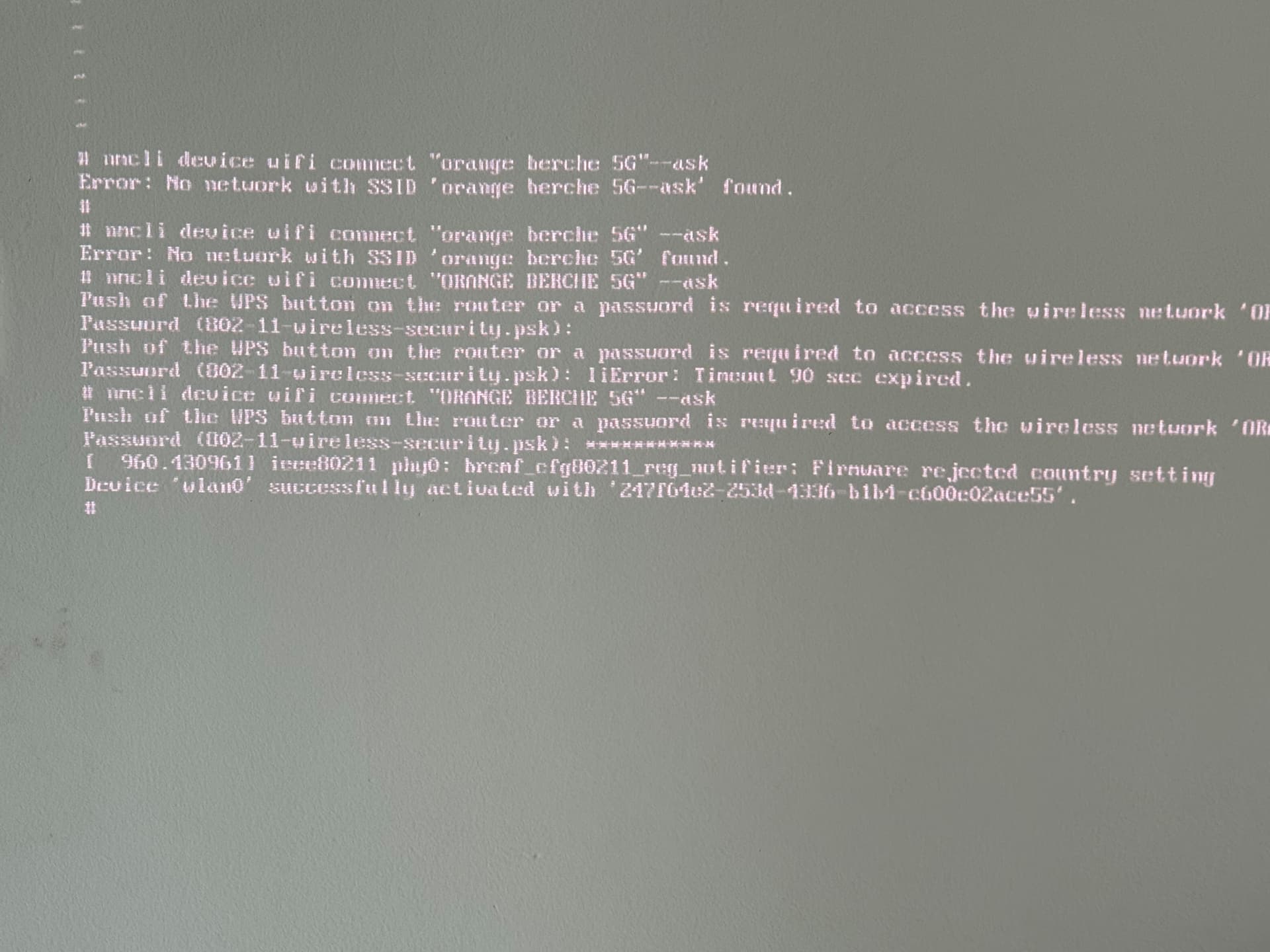

By connecting the Wi-Fi directly from the Rbi4, I received this message
Looks like your WiFi credentials have not been defined.

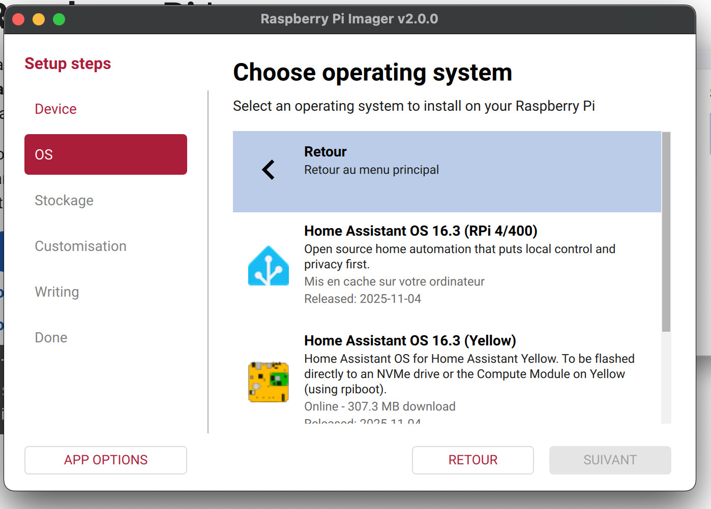

I used the Raspberry Pi Mac OS application and the HA 16.3 firmware, which I copied directly to an M.2 SSD. Then I connected the screen and keyboard to the Raspberry Pi to select the Wi-Fi network and password.

Ii note the new imager was just released by Raspberry Pi. Any bug reports in the forums for it? English or French versions?
If you are certain that the WiFi network credentials were correctly entered and saved (please go back and check them carefully), there may be a problem with the Raspberry Pi imager software not writing the start-up configuration file correctly to the correct drive, or the HomeAssistant OS installation routines not finding it as it is unpacking the startup installation routines.

Does it work any different using the older version of the imager software? Does it work with the standard Raspberry Pi software instead of the HomeAssistant one (just to see if it actually writes the credentials out correctly)

How have you connected your M2 SSD to the Mac?
Update: I found this: [BUG]: SSH Public Key Authentication Casus Customisations (Hostname, User, Locate) to Fail to Apply in Imager v2.0.0 · Issue #1320 · raspberrypi/rpi-imager · GitHub and this [BUG]:Enabling SSH does not enable SSH · Issue #1242 · raspberrypi/rpi-imager · GitHub in the Raspberry Pi Imaging GitHub repository bug reports - maybe the problem lies with the actual image being downloaded or the way it is written by the imager and not HomeAssistant at all?
Assumption the imager software is working correctly may be incorrect. Yikes!
