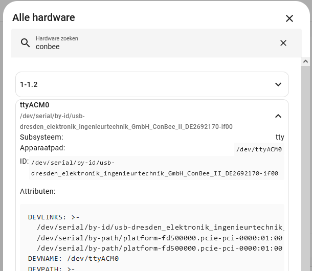

Are you sure of your serial port?
Settings → system → hardware and click on All Hardware. Then search for Sonoff. Mine is on ttyUSB0. My Coral dongle is on ttyACM0.
ttyUSB0
DEVLINKS: >-
  /dev/serial/by-id/usb-dresden_elektronik_ingenieurtechnik_GmbH_ConBee_II_DE2692170-if00
  /dev/serial/by-path/platform-fd500000.pcie-pci-0000:01:00.0-usb-0:1.2:1.0
  /dev/serial/by-path/platform-fd500000.pcie-pci-0000:01:00.0-usbv2-0:1.2:1.0
DEVNAME: /dev/ttyACM0
DEVPATH: >-
  /devices/platform/scb/fd500000.pcie/pci0000:00/0000:00:00.0/0000:01:00.0/usb1/1-1/1-1.2/1-1.2:1.0/tty/ttyACM0
ID_BUS: usb
ID_MODEL: ConBee_II
ID_MODEL_ENC: ConBee\x20II
ID_MODEL_ID: '0030'
ID_PATH: platform-fd500000.pcie-pci-0000:01:00.0-usb-0:1.2:1.0
ID_PATH_TAG: platform-fd500000_pcie-pci-0000_01_00_0-usb-0_1_2_1_0
ID_PATH_WITH_USB_REVISION: platform-fd500000.pcie-pci-0000:01:00.0-usbv2-0:1.2:1.0
ID_REVISION: '0100'
ID_SERIAL: dresden_elektronik_ingenieurtechnik_GmbH_ConBee_II_DE2692170
ID_SERIAL_SHORT: DE2692170
ID_TYPE: generic
ID_USB_DRIVER: cdc_acm
ID_USB_INTERFACES: ':020201:0a0000:'
ID_USB_INTERFACE_NUM: '00'
ID_USB_MODEL: ConBee_II
ID_USB_MODEL_ENC: ConBee\x20II
ID_USB_MODEL_ID: '0030'
ID_USB_REVISION: '0100'
ID_USB_SERIAL: dresden_elektronik_ingenieurtechnik_GmbH_ConBee_II_DE2692170
ID_USB_SERIAL_SHORT: DE2692170
ID_USB_TYPE: generic
ID_USB_VENDOR: dresden_elektronik_ingenieurtechnik_GmbH
ID_USB_VENDOR_ENC: dresden\x20elektronik\x20ingenieurtechnik\x20GmbH
ID_USB_VENDOR_ID: 1cf1
ID_VENDOR: dresden_elektronik_ingenieurtechnik_GmbH
ID_VENDOR_ENC: dresden\x20elektronik\x20ingenieurtechnik\x20GmbH
ID_VENDOR_ID: 1cf1
MAJOR: '166'
MINOR: '0'
SUBSYSTEM: tty
TAGS: ':systemd:'
USEC_INITIALIZED: '3599117'
I also tried ember as instructed by the deprecation warning, but that also resulted in errors. The mqtt I didn’t fill in because the tutorial said: If you don’t use the mosquito broker addon, fill in the mqtt. I am using the Mosquito broker addon, so I skipped that. I also don’t have any url, port and password info to fill in there. I expect that to be handled by the addon
I found out where this information was: settings / devices and services / mqtt / config / reconfigure.
I now also added the mqtt to the configuration, including the password I found in the MQTT configuration (which I replaced here in the forum with [MASKED] like in the other example)
I also changed ezsp to ember. Now I get this error message. Seems like it still want to do something with ezsp.

It looks like it can not open /dev/ttyACM0
Resource busy… that is like it is already doing something…
I trired rebooting the raspberry Pi 4, and I also tried to change the serial port name to:
which is the name I found in the config of deCONZ. But the result remained the same.
