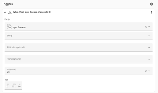

The trigger would be the state of your input_boolean changing to “on” (all these things are in drop-down lists - you don’t have to type them out):
