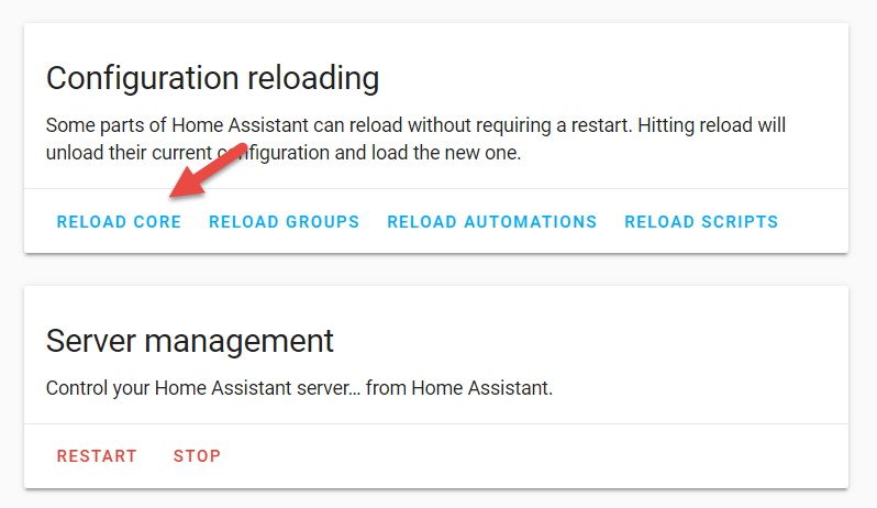

Do I have to reboot or restart anything ? I’m currently always restarting the management server.
Thx
You have to restart Home Assistant when you modify configuration.yaml
No idea what this means.
That only reloads customizations. RESTART home assistant
I’ve tried !!
