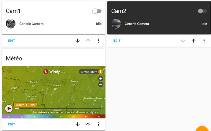

Yes, I’m trying for example to connect to two Hikvision cameras.
if trying to add stream, you’d find the appropriate component from here
and add to your configuration .yaml
Ok I’ve found using a generic entry. What is the idle toggle ?
