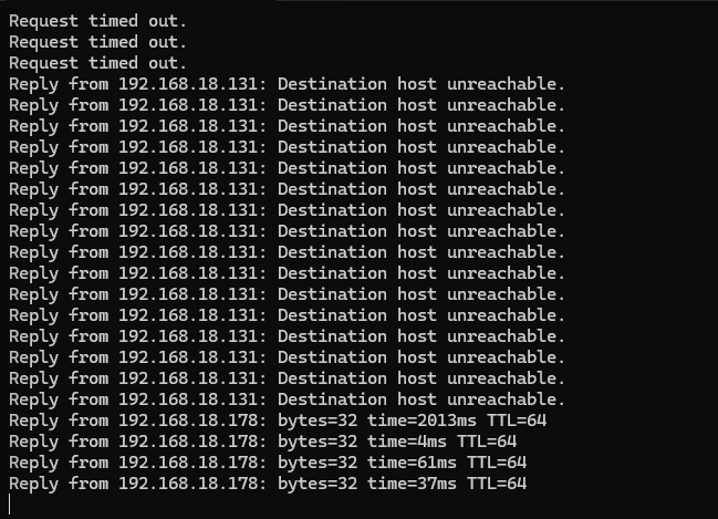

before cant access i already connect but when installation start always fetch log error and i try ping it always like this the connection

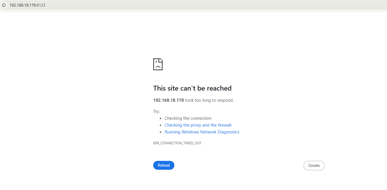

me too. I was able to connect to the Home Assistant web page. However, now I cannot access the webpage.
I have checked the ipaddress and I am using the correct ip address
How do you know?

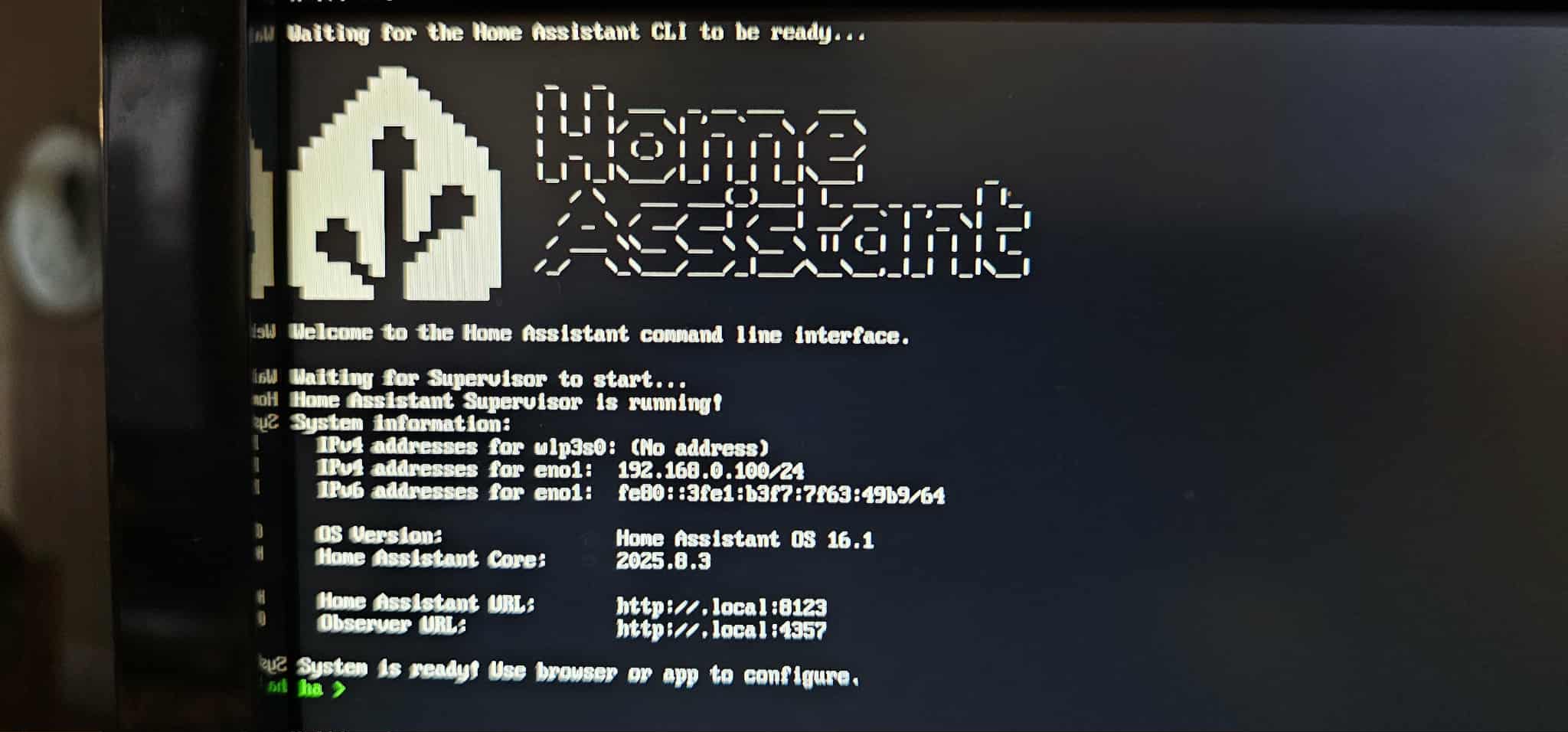

What do you see on the terminal plugged into the Pi?
Neither of them is the screen from the Pi you are installing on…

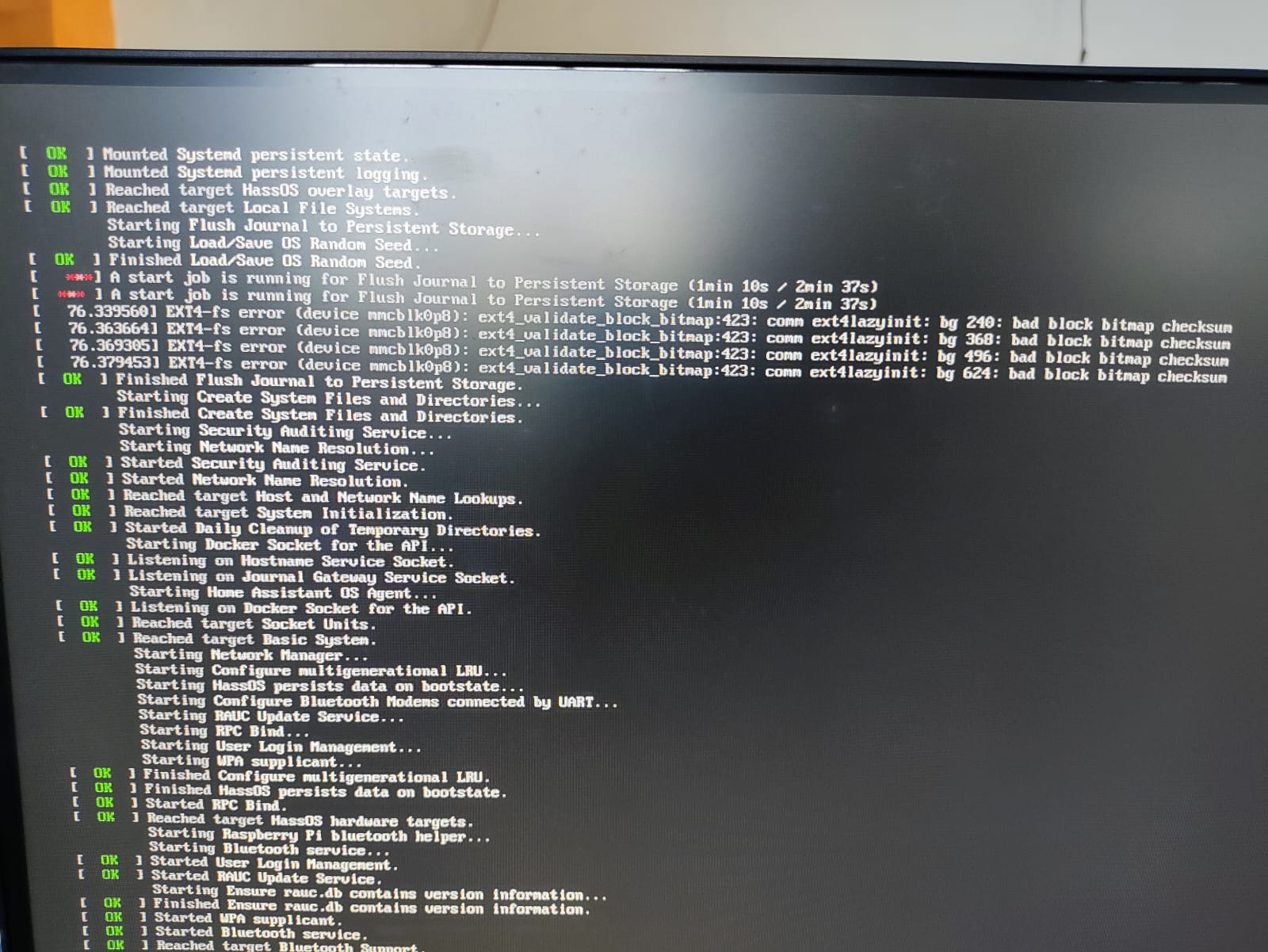

the server always restart
You appear to have issues with your storage. Use a better quality SD card and see if that helps. The system is not ready to connect until you see a display that looks similar to this:
connect your pi with a monitor, generally the monitor shows ip address of your pi. In my case, sometimes it has two ip addresses, one with the wifi and one with the LAN.

To the OP: Is your RPi multi-homed to both the wired and wireless networks? I’ve never had good luck with that on my RPi.
Next, are you sure that what you’re pinging is the IP address of the correct adapter on the RPi? If you’re using DHCP, there’s no guarantee it’ll pick up the same address after reboot, unless you’ve added a reservation in your router. Or just hard-code the IP address in the device, and make sure it’s outside your DHCP range.
Make a note of the mac address of the desired adapter on the RPi and check your router (or your local arp table with the arp - a command) to see if you’re really connecting to the right host.
