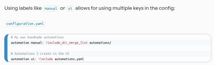

From what I’ve read… for HA to read my manually created automation file, the configuration.yaml needed to be modified with the following line added:
automation: !include_dir_merge_list myautomations/
I still have the original automation line in the config file so it looks like this:
automation: !include automations.yaml
Am I good so far??

There are a few possible reasons why you aren’t seeing your automations.
  1. Any time you add or edit a configuration file, you need to restart HA for the changes to be incorporated.
  2. Because of small syntax differences between what is used in the “Edit in YAML” option in the UI editor, automations.yaml, and files using the different merge methods; you can’t always just copy/paste config directly from one to the other.
Be aware, that even when your manual automations are visible in the list in Automation settings, they are not editable through the UI unless you migrate them back to automations.yaml.

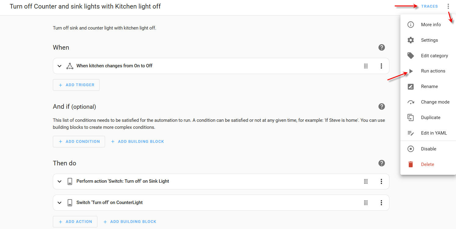

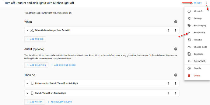

Find an automation you want to modify (or copy) and click on the three-dot menu “edit in yaml”. Copy this code. (YAML isn’t code, but it’s called code everywhere). Back out of this automation. Then “create automation”, “create new automation”, go straight to the three-dot menu and “edit in YAML”. Replace everything with the YAML configuration that you copied. Make your changes, experiment, and when done make sure you save the new automation with a unique name. Now you can run the actions and look at the trace to figure out where it stopped.
Then you can come back here for assistance. We will want to see the YAML configuration (use code tags </>), and maybe a screenshot of the trace would help.

reYes I did… I did a side by side comparison of the two lines, added the automation manual: automation ui: to my file saved, went to Developer tool > YAML > Check configuration… that replied Ok, did a Automation check… that came back Green as well, did a HA Restart, checked both the Settings > Automations & scenes, my test1.yaml wasn’t visible, and lastly I looked in Developer tools > States to see if it showed up there as unavailable, or off… the test1.yaml just wasn’t to be found… at least by me so far

This may sound daft but if you want to edit or add automations in yaml, why not just click the 3 dots in ui editor? This will give you a check of your yaml when you try to save it, rather than messing about trying to fix a HA instance that won’t start because you made a mistake.

As I said before, start by creating a simple automation using the UI editor. Then copy the YAML configuration. Create a new automation and immediately switch to the YAML editor. Paste your saved configuration and modify a few parameters. When you save it, Home Assistant will lint the YAML and alert you to any syntax issues.
