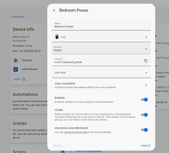

Click on the device, go to settings and find out the real name :slight_smile: It should start with media_player
i.e. media_player.kitchen
Here’s an example :
Thank you Neil!! That solved for it - will look more careful at the naming mechanic.
