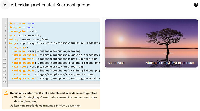

Still no moonphase picture.
I made the changes: but … no moon top left corner.
Any suggestions?
or the code:
show_state: true
show_name: true
camera_view: auto
type: picture-entity
entity: sensor.moon_fase
image: /api/image/serve/8f1e1c919636a3f07b2c6aef8fd29293/512x512
state_image:
  New moon: /images/moonphases/xnew_moon.png
  Waxing crescent: /images/moonphases/xwaxing_crescent.png
  First quarter: /images/moonphases/xfirst_Quarter.png
  Waxing gibbous: /images/moonphases/xwaxing_gibbous.png
  Full Moon: /images/moonphases/xfull_moon.png
  Waning gibbous: /images/moonphases/xwaning_gibbous.png
  Last quarter: /images/moonphases/xlast_quarter.png
  Waning crescent: /images/moonphases/xwaning_crescent.png
Read the link in my last post. These are URLs under state_image. Does this work for you if you fill in the IP address and paste into your browser?
http://[YOUR HA IP]:8123/images/moonphases/xnew_moon.png
If it doesn’t display the image, then it won’t work in the picture card either. Read the link and work out how to display stored images via your browser.
Also, what is the actual state of the sensor? Is it “Waning crescent” or “Afnemende, sikkelvormige maan”? Go to Developer Tool / States and see what the result is for:
{{ states('sensor.moon_fase') }}
The states are wrong, it has to be:
  waxing_crescent
  first_quarter
  waxing_gibbous
  full_moon
  waning_gibbous
  last_quarter
  waning_crescent
Yep thats the problem: I dont see it im all of my browser
404 error
/my-ip:8123/local/images/moonphases/waning_crescent.png
if i type the above in my browser i see the picture
But still not in the moon state
