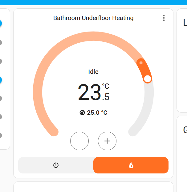

A first post here to say I have followed the posts above to get a MOES unit (via Amazon) working on the HA set up I have.
As others found, the Zigbee HA subsystem discovered only the basic info. By adding the quirk, and following the instructions it then sprang into life. The working widget is as [hopefully] shown below.
I’ll keep testing this over the coming months and post an update if any issues found.
My thanks again to the community.
