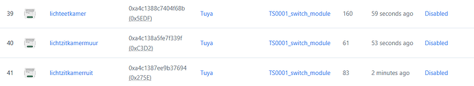

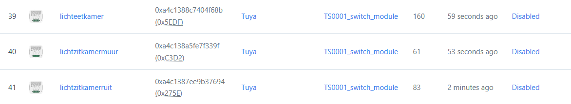

Actually the device i try to permanently add it is a Tuya TS0001_switch_module

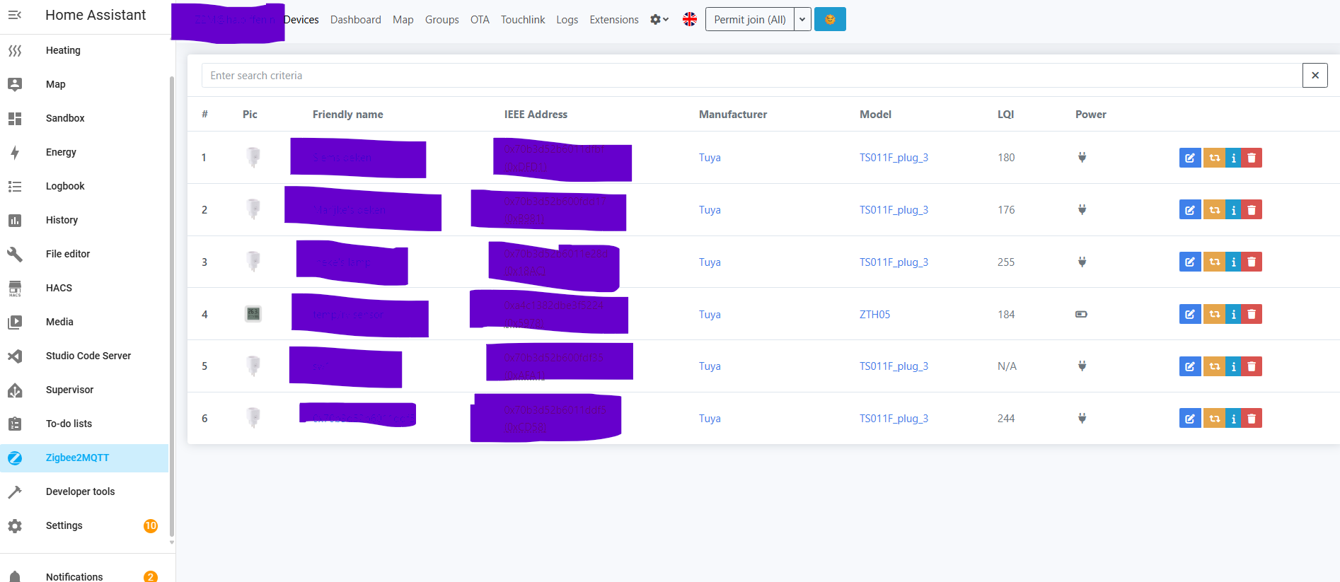

( there are no problems with the TS011F_plug_3 devices which are listed in thge screenschot )
I have several, they don’t drop off the network

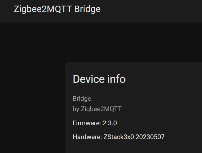

I’m using Coordinator revision 6.10.3.0 build 297 with Sonoff dongle, it do not know yet how old this is
Again, you don’t mention what specific model of Sonoff dongle you’re using. Sonoff make quite a few zigbee coordinators, so you need to help us help you.
Anyway, you should be able to get the info by searching for your coordinator in HA > Settings > Devices & Services list.
Your coordinator device page should have this listed in the Device Info section, next to the Hardware field:

Hmm, you might have to check the zigbee logs after a restart to see the firmware version in your case. See Flashing the firmware on the CC2538 MODULE | Zigbee2MQTT.

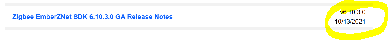

Yeah, and according to this, that firmware is from 2021

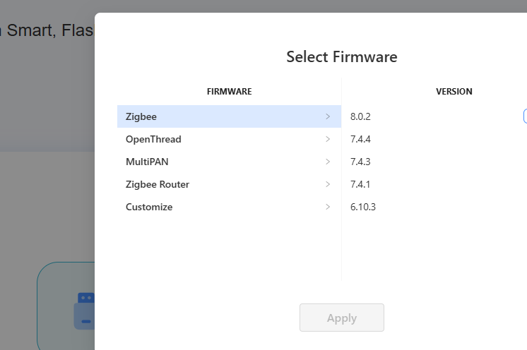

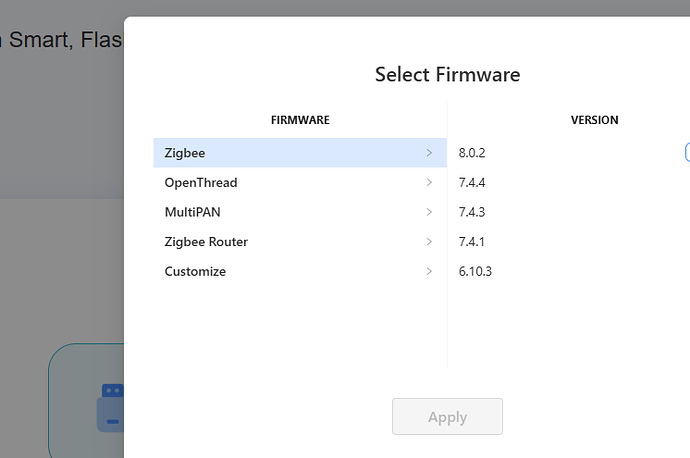

I’m trying to flash new firmware on my sonoff Dongle E.
I’m not sure which type and which version
Zigbee 8.0.2
