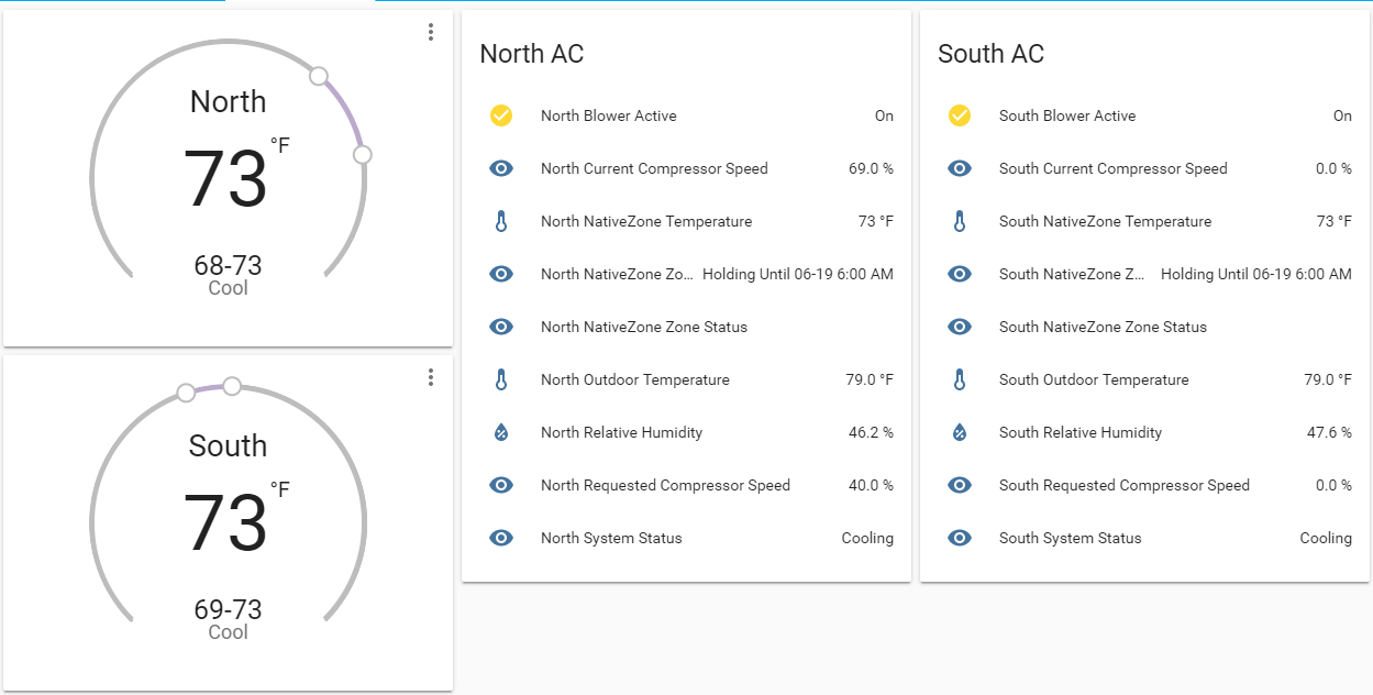

Hi Ryan, thanks so much for your work on this. I have a pair of American Standard (Trane TEM8) and the XL1050 Thermostats. I managed to get them going with your process, but have something weird. One unit shows the Compressor speed properly and the other shows it as 0% which is incorrect for sure. The other odd thing is that in the temperature control of the North unit has the adjustments (not sure that the correct name is) between 1 o’clock and 2 o’clock and the south unit has them like between 11 and 12 noon. Any ideas why that will be the case?
I guess the Requested Compressor Speed is odd too.

And it seems that if the blower is off, the compressor does not turn off. It has been solid at 69% since I restarted HA.

The compressor speed with my system seems weird too, but that’s what Nexia is reporting. You can always cross check on the Nexia app.
As for the scaling, it’s based on the reported maximum and minimum temperatures for that zone. You can go to the states panel and view what your mom and max is within the climate controls attributes.

How are you guys getting compressor speed? I’m not seeing it anywhere…
First, you have to have a system that supports variable speed control.
Second, in your sensor configuration, you would need to add platform: nexia.
Oh, I see. On one unit is min_temp: 45, max_temp: 80 and on the other is min_temp: 45, max_temp: 100. Is that setting on the thermostat itself or just adjusting the states?
The json returned from Nexia has the second unit compressor on zero, so that is how they are reading it.

Here are both units side by side…
current_temperature: 74 current_temperature: 75
min_temp: 45 min_temp: 45
max_temp: 80 max_temp: 100
temperature: 74 temperature: 75
current_humidity: 45.2 current_humidity: 48.6
humidity: 45 humidity: 45
fan_mode: auto fan_mode: auto
fan_list: auto,on,circulate fan_list: auto,on,circulate
operation_mode: AUTO operation_mode: AUTO
hold_mode: none hold_mode: none
away_mode: off away_mode: off
attribution: Data provided by nexiahome.com attribution: Data provided by nexiahome.com
target_temp_high: 74 target_temp_high: 75
target_temp_low: 70 target_temp_low: 70
target_temp_step: 1 target_temp_step: 1
operation_list: AUTO,COOL,HEAT,OFF operation_list: AUTO,COOL,HEAT,OFF
model: AZON1050AC52ZAA model: AZON1050AC52ZAA
firmware: 5.5.1 firmware: 5.5.1
thermostat_name: North thermostat_name: South
setpoint_status: Following Schedule - Sleep setpoint_status: Following Schedule - Sleep
zone_status: zone_status:
thermostat_id: 1581922 thermostat_id: 1741377
zone_id: 0 zone_id: 0
min_humidity: 35 min_humidity: 35
max_humidity: 65 max_humidity: 65
friendly_name: NativeZone friendly_name: NativeZone
supported_features: 1481 supported_features: 1481
