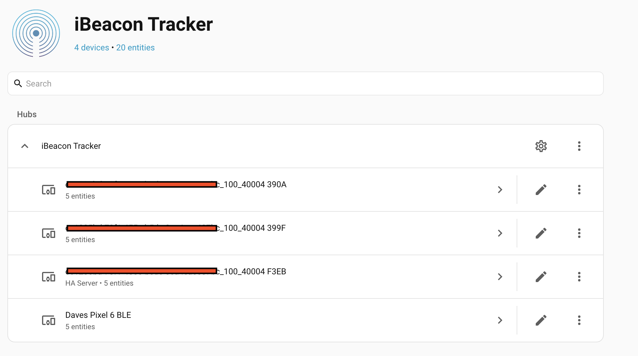

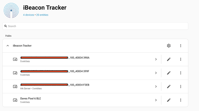

No idea what to do here - it seems each time i turned BLT off on my phone, it creates a new device but they are still “Away”
The bottom entry was made when i first installed and pasted my UUID in the iBeacon tracker.
No idea what to do here - i rebooted HA in a fit of desperation, it returned with two “Home” devices which seemed odd, after about 6 - 10 minutes, both devices changed to “Away” despite the phone sitting here next to me.
I can’t see any help on Google so apart from deleting it all what can I try here??
Any help appreciated.
