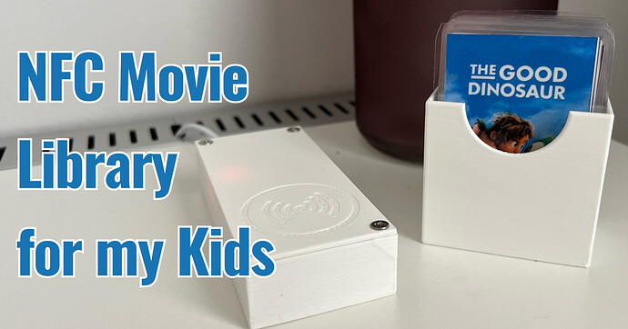

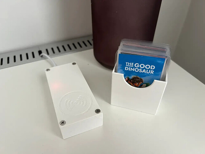

Wanted to share a project I made for my kids: a movie library based on NFC tags.
I wanted to bring back the physicality of VHS tapes and DVDs.
The idea is simple: they browse through our catalog, pick a card, put it on the scanner, and watch a movie.
On the hardware side, I used an ESP32 (C3 Super Mini) and the RC522 NFC reader. The ESP32 is flashed with ESPHome for seamless integration with Home Assistant and local control.
