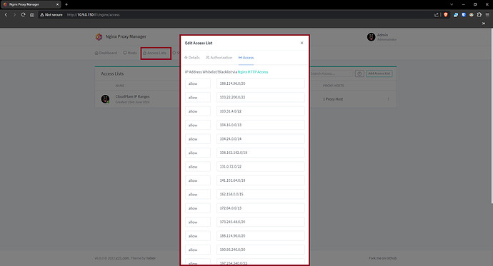

After installing the NPM on Ha & doing a basic setup it was ready to use. As I am using CF Proxy I added CF Networks to the access list of NPM.

Finally I setup a new host [test1] pointing it to my internal address for the HA Server, adding the access list created and CF certificate to it.
Access List
