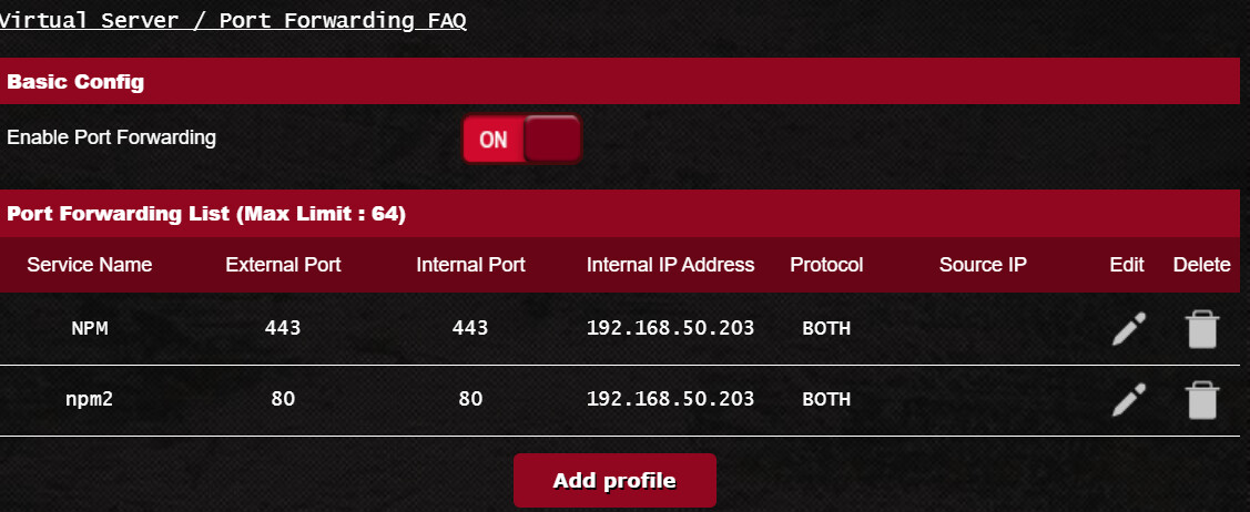

Here are my port forwarding rules. What do I put in NPM? In my config.yml I put the network ip address, not the public Ip. Is that correct?
For your port forward rules, you do not need to include an internal port, just the external port.

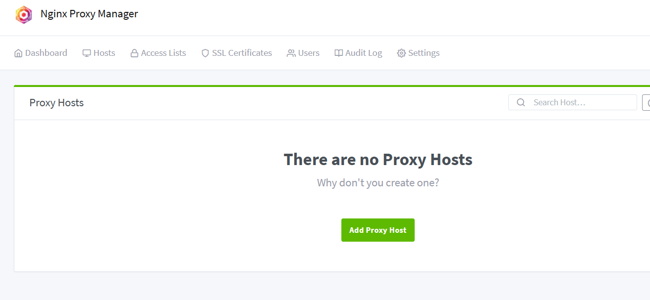

I have nothing in my NPM as of yet, it is an empty slate, what do I put in there?
Picture of what is in my NPM.
From here, add a proxy host, add your domain (full subdomain address, like mysubdomain.duckdns.org), scheme is http, use your HA local ip, the port HA is using (if you left it default, it’s 8123), and I’d keep Block Common Exploits and Websockets Support toggled on. As long as you are using the correct trusted proxy address in the config, it should work.
Regarding SSL, if you’re using it (which you should for external access), I’d keep Force SSL and HTTP/2 Support toggled on
But, again, the subnets you’re using as a trusted proxy needs to include the Supervisor Docker Network subnet. Which, as I’ve mentioned previously, is probably 172.30.33.0/24 or 172.30.32.0/24. I doubt your local subnet 192.168.50.0/24 will suffice by itself.
