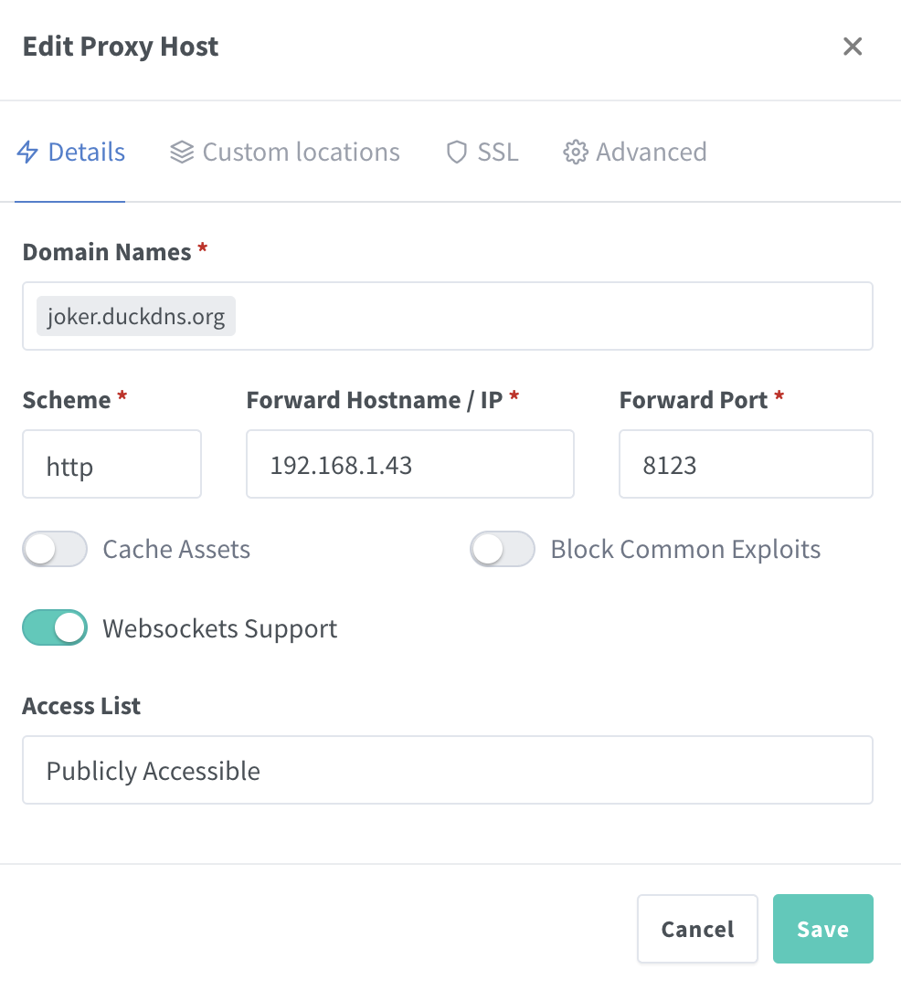

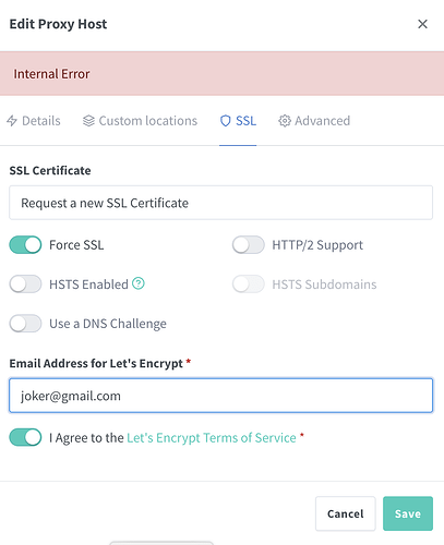

i tried to add a nginx proxy manager but it fails all the time with internal error.
6/23/2024] [12:53:00 PM] [Express  ] › ⚠  warning   Command failed: certbot certonly --config "/etc/letsencrypt.ini" --work-dir "/tmp/letsencrypt-lib" --logs-dir "/tmp/letsencrypt-log" --cert-name "npm-5" --agree-tos --authenticator webroot --email "[email protected]" --preferred-challenges "dns,http" --domains "joker.duckdns.org"
Saving debug log to /tmp/letsencrypt-log/letsencrypt.log
Some challenges have failed.
Ask for help or search for solutions at https://community.letsencrypt.org. See the logfile /tmp/letsencrypt-log/letsencrypt.log or re-run Certbot with -v for more details.
this is my setup in the UI
i don t get the problem. what is wrong?

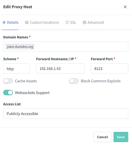

i tries it with the right duckdns adress. just to anonymize my account
http://joker.duckdns.org does not seem to redirect to a valid host. So, Certbot’s http challenge fails.
[6/23/2024] [2:09:36 PM] [Express ] › :warning: warning Requested name http://joker.duckdns.org appears to be a URL, not a FQDN. Try again without the leading “http://”.
hmm?
Certbot’s http challenge requires that a host or server is answering on your domain name.
