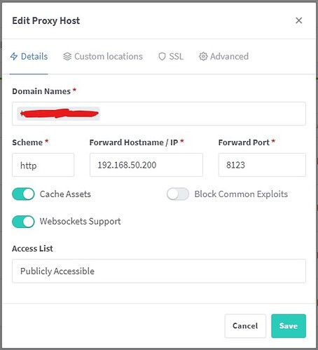

config:
config
My docker is configured as:
Hass → macvlan 192.168.50.200
NGINXPM → host
NGINX config:
proxy2
Ive seen other posts using NGINX but not the GUI so i cant get as fine control over the config and i cant find the location of the stored configs for nginx (new to this so might be completely off)

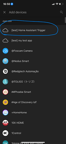

Google integration:
