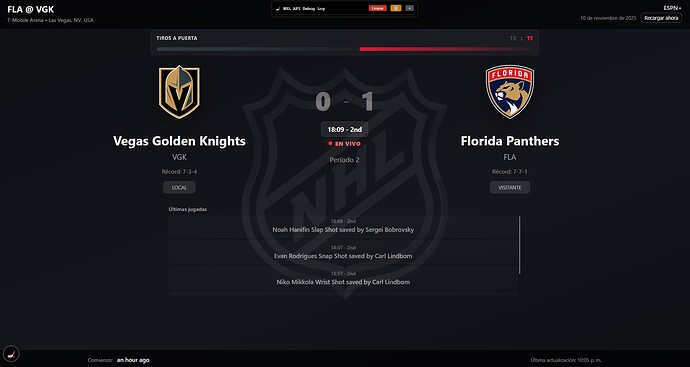

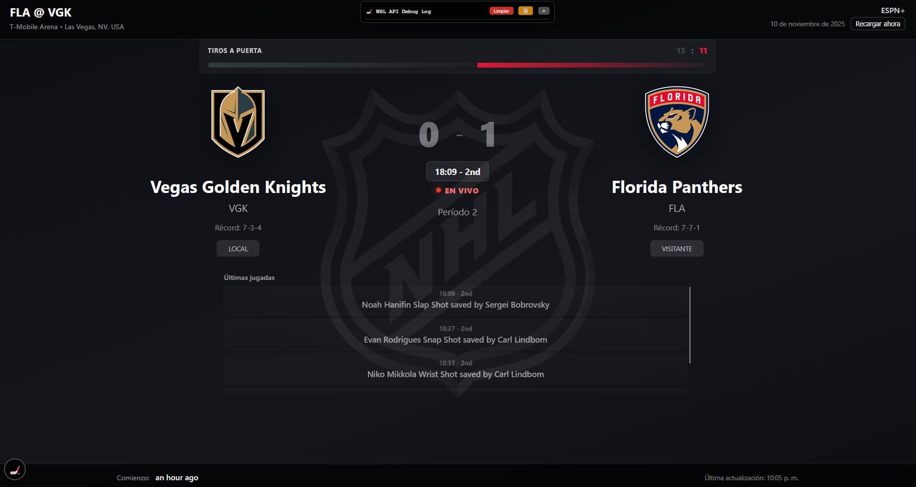

I built a live NHL game tracker panel for Home Assistant that shows real-time scores, power plays, shots, and play-by-play updates. No external dependencies, works 100% through HA sensors. GitHub link at the bottom!
Background
I’m not a programmer, just a hockey fan who wanted to track my favorite NHL teams on my Home Assistant setup. With help from Claude AI, I built this panel over several iterations. Sharing here in case others find it useful!
What It Does
  • Live Score Tracking: Real-time game scores with team colors and logos

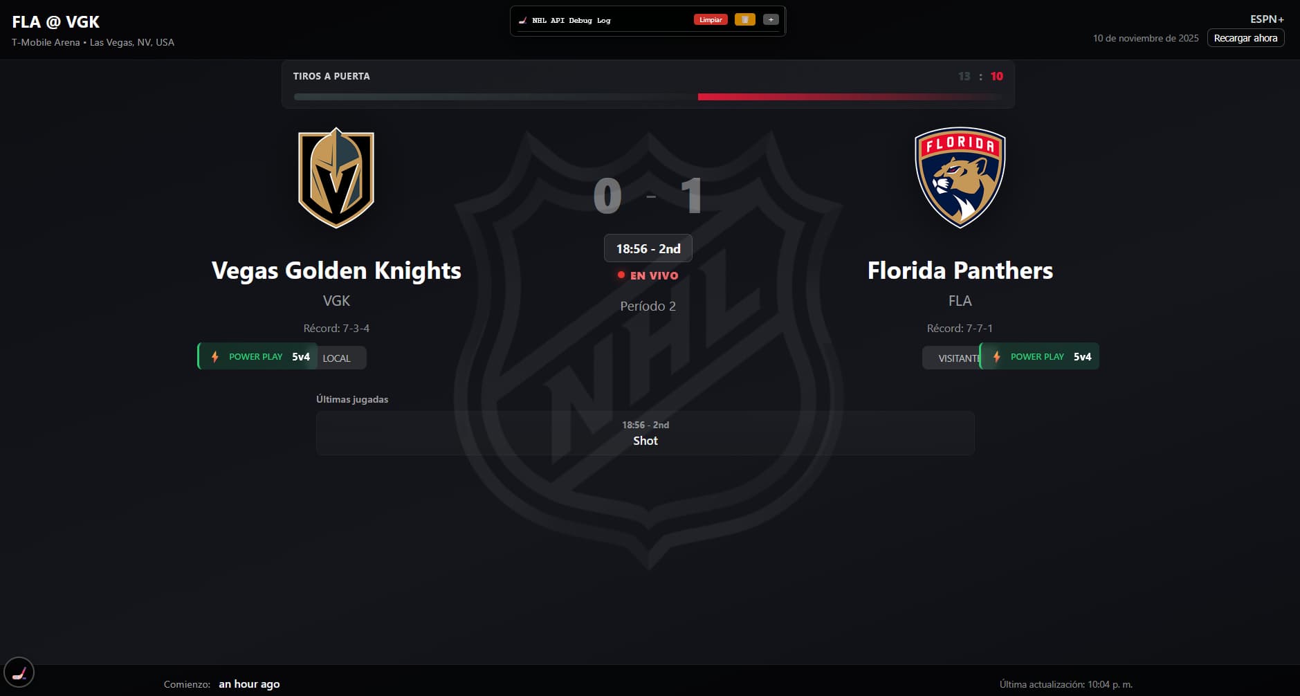

  • Power Play Indicators: Dynamic cards that show when your team (or opponent) has a power play, including situation (5v4, 5v3, etc.)
  • Shots on Goal: Visual bar chart comparing shots between teams
  • Play-by-Play Feed: Last 10 plays with timestamps, auto-scrolling
  • General dominance indicator
  • Faceoff info
  • Hits and blocked shots
  • Delayed penalty (Please note that you will not always be able to see it, due to the API update time and the duration of the delayed penalty, which usually takes just a few seconds.)
  • Empty Net indicator
  • Goal Animations: Border flash effect when goals are scored
  • Smart Refresh Rates:
    • 15 seconds during live games
    • 2 minutes before game starts
    • 5 minutes after game ends
  • Telegram Notifications: Optional goal alerts with highlight video links

  4. Power Play Detection uses situationCode from NHL API to accurately track when teams have advantage
Key Features
Power Play System:
  • Detects penalties automatically
  • Shows power play card on the team with Text advantage
  • Updates dynamically (5v4, 5v3, 4v3, etc.)
  • Automatically removes when game returns to 5v5
  • Pauses correctly during intermissions

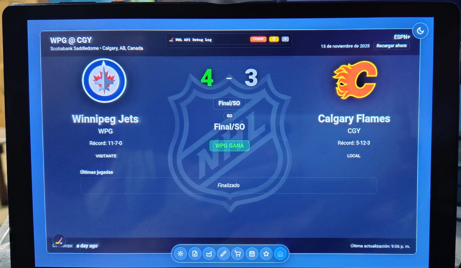

This is awesome but I cant get the dashboard up and running. All the sensors were created and Im able to view the entities in HA. I also copied the english html file but the screen im stuck at says “Conectando con Home Assistant/ Verifica URL y TOKEN”. The debug log at the top has the correct monitored team
Thank you for the comment. I see that there are still portions left to translate. The error you are experiencing is due to an incorrect URL or problems with the HA token. Could you please check that you have entered the token correctly and that you are accessing the correct URL where the HTML is stored? http://yourIP:8123/local/nhl.html I will review the file to confirm that there are no errors in the code.
Edit:
Small error in the code, you can use the new one I just uploaded to GitHub. Let me know if any issue comes up.

@kevvar First of all, this is a sick board! way cooler than the team tracker one. Are you finidng the api pretty frequently not updating the power plays or penalty kills? I am finding it a 50/50 if it updates, ,or at the end of the game, it starts triggering.
Also, a few items still only populate in Spanish.
Sorry for the late replay. In theory, the API updates every 15 seconds. At times, it takes a while as the code analyzes the 5vs4 event or according to the number of players in a penalty. I will review the code to find any inconsistencies. When you can, please detail what still appears in Spanish to make the necessary translations

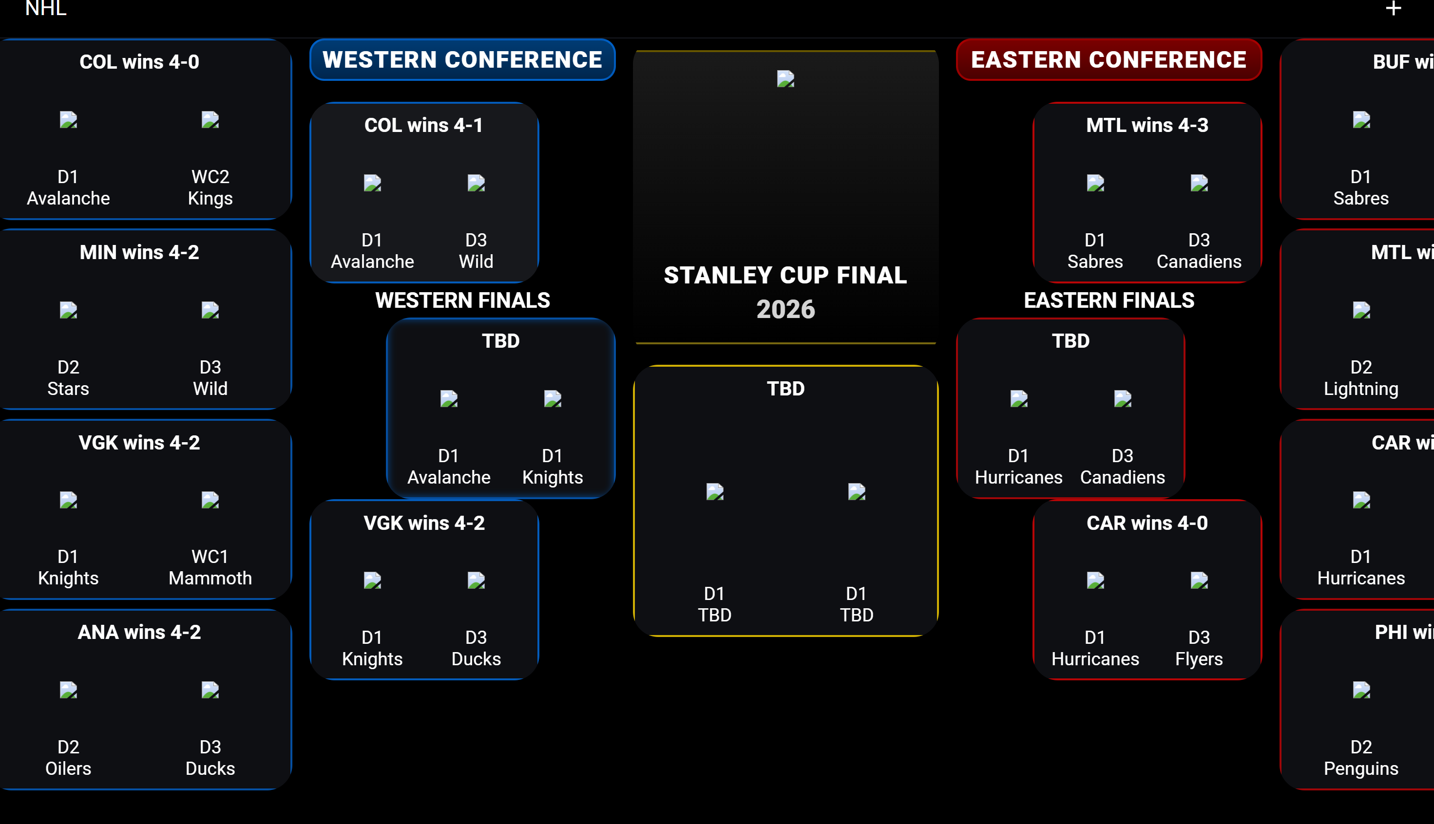

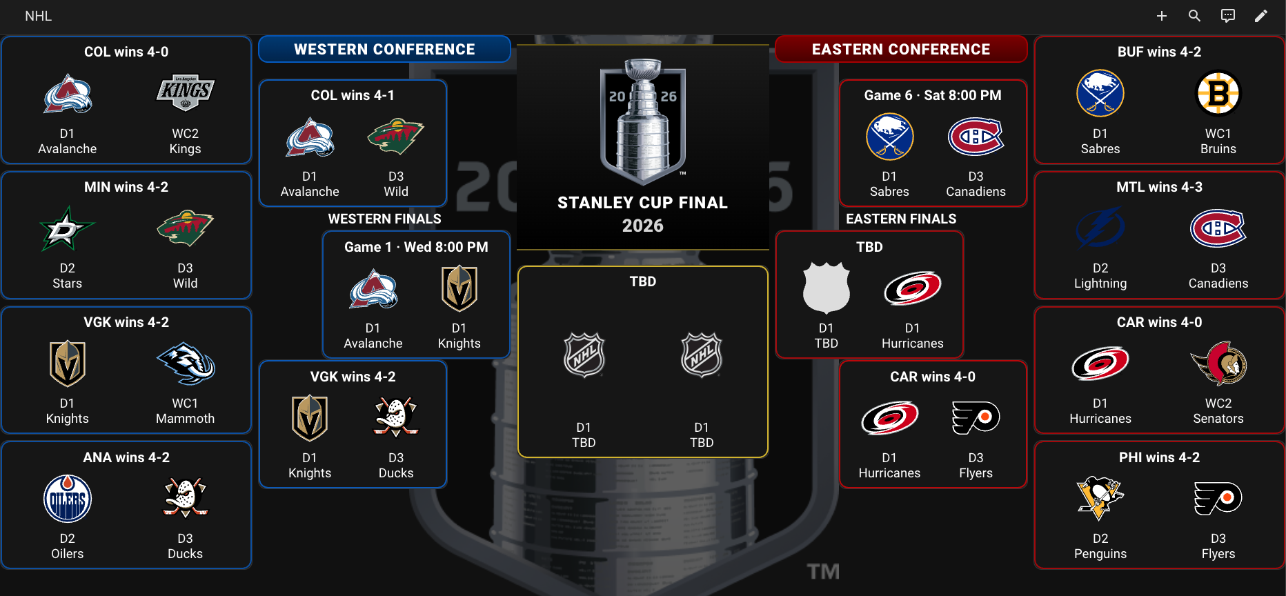

Really like what you’ve done here — clean live stats and a nice single‑team view.
I’ve been working on something similar but on a bigger scale for the full playoffs. Mine includes the entire bracket layout, all rounds, and a live game card that switches automatically.
If anyone wants to see a full‑bracket approach, here’s my setup: GitHub - astlgit/nhl_playoffs_ha_dashboard · GitHub
Not trying to take away from your post at all — just adding another angle for folks who want a full‑series view.
If you ever want to bounce ideas around or combine approaches, I’m totally down. Happy to help or collaborate if you want to expand yours or take a look at mine for direction.

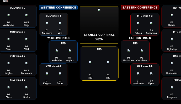

I tried yours, but for some reason my dashboard looks like that

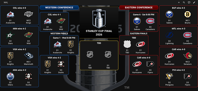

what does your sensor look like and what version are you on, weird that its pulling all the data but its not showing any of the images/logos
All this time it was not a problem. My work PC not aloud to pull any data from NHL site.
