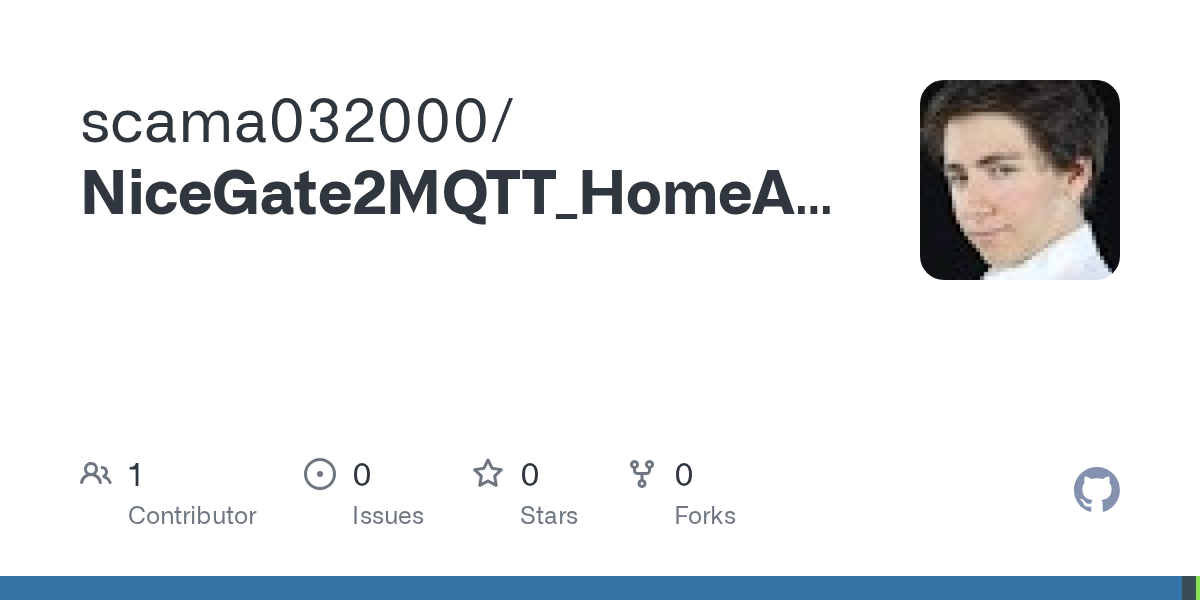

If you still search a way to fully control your gate with IT4WIFI module, and do not want to use HK (it is missing some command) I created an addon to control the gate with MQTT. It should have every command available in the Nice app.
