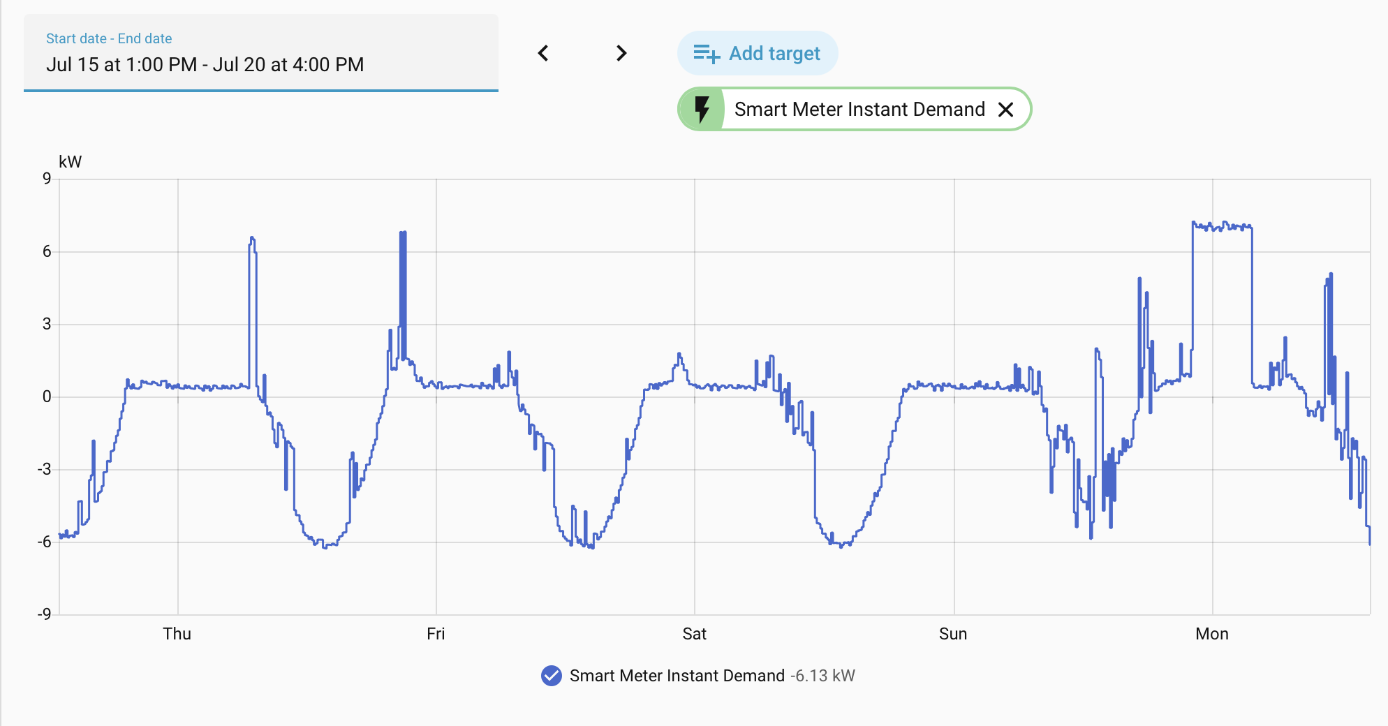

Hi. This is a great concept and something that I was thinking of building.
Question: what’s the best recommended way to remove solar production from the mains? (OR do I even need to do it?)
my mains sensor includes the negative power I give back to the utility. See in this picture the negative sinewave is the solar production during the day. The big square wave last night is the car charging.
Should I create a computed sensor that subtracts solar production from the power read from the utility?
Yes, the recommended approach is to create a calculated sensor representing the home’s actual consumption and use that as the mains sensor in HA-NILM.
Although HA-NILM accepts negative readings and may still work when solar production is stable, changes in solar output can hide appliance activity or be mistaken for appliance events. Using a consumption sensor with the solar contribution already removed should provide cleaner input and more reliable results.
