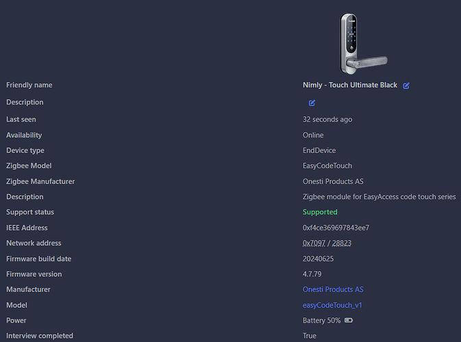

I was replacing some batteries in my Zigbee network the other day and thought now I am going to get that Nimly lock module replaced with a newer version to fix the 50% battery bug.
Got a new module today and put it in. Still shows 50% with new batteries.
I read the posts a bit back in this thread but dont quite understand if its something I need to change or if its been merged into the code when we update Zigbee2MQTT.
This is how it shows up now:
Is it something I need to/can do to fix this?

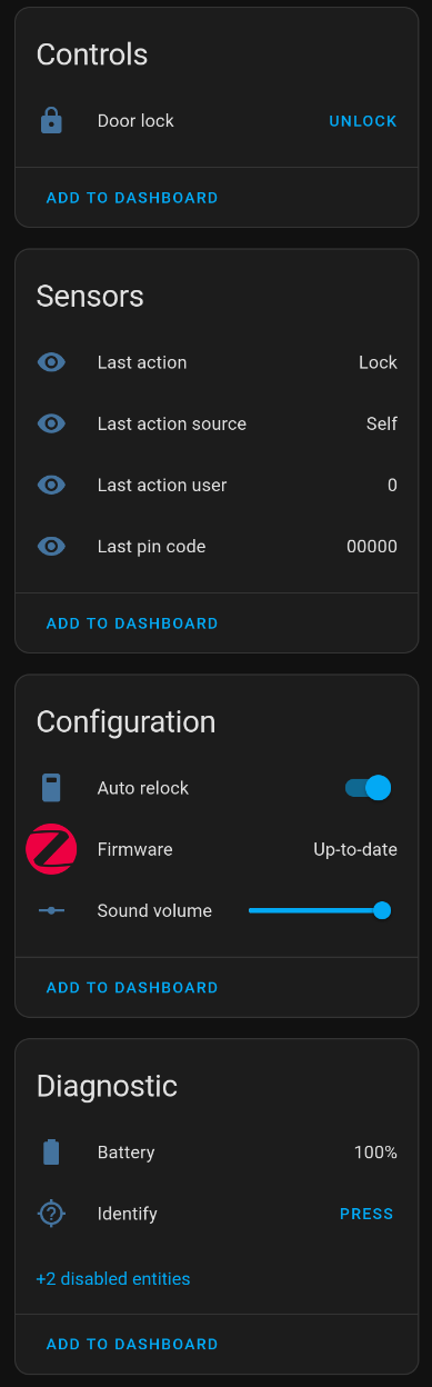

I just created a PR in ZHA that adds the following fields for Nimly locks:
  • Last action source
  • Last action
  • Last action user
  • Last pin code
  • Auto relock
  • Sound volume
