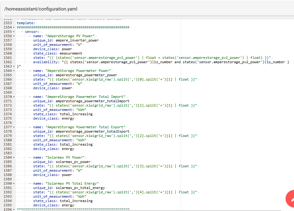

This script saves the values as attributes of an entity and not as the state. You can transform those back into their own entities by using a template sensor.
template:
sensor:
- name: Value0
unique_id: value0
unit_of_measurement: "W"
device_class: power
state_class: measurement
availability: >-
not state_attr('sensor.solar', 'value0') == None
state: >
{% set value = state_attr('sensor.solar', 'value0') | float %}
{{ value }}
This is the part I am not sure about if there is a better solution, converting attributes to their own entities with states. But it is working.
You can give the attributes proper names in the python script and use them in the template sensors.
