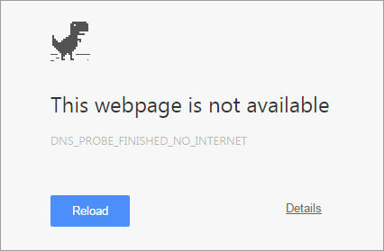

when I try https://hassio.local:8123 I get “page not loaded” and at the bottom it says “DNS_PROBE_FINISHED_NXDOMAIN”
