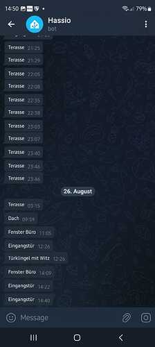

I experienced that after midnigt no new message for alexa and telegram incoming, after i reload the homematicip integration (or boot system), so i build a automatic rule on 3 am, what this is not working (no new messages from kids and wife) until i start the rule manually on about 9am - every day - and all actions are working normal, this is actually every day so. Meanwhile it worked for two days, what then not
its working until 0:00 oclock, no message from 0 - 3 pm, then one or two old mesassage at 3 oclock und then nothing until i start automation manuell.

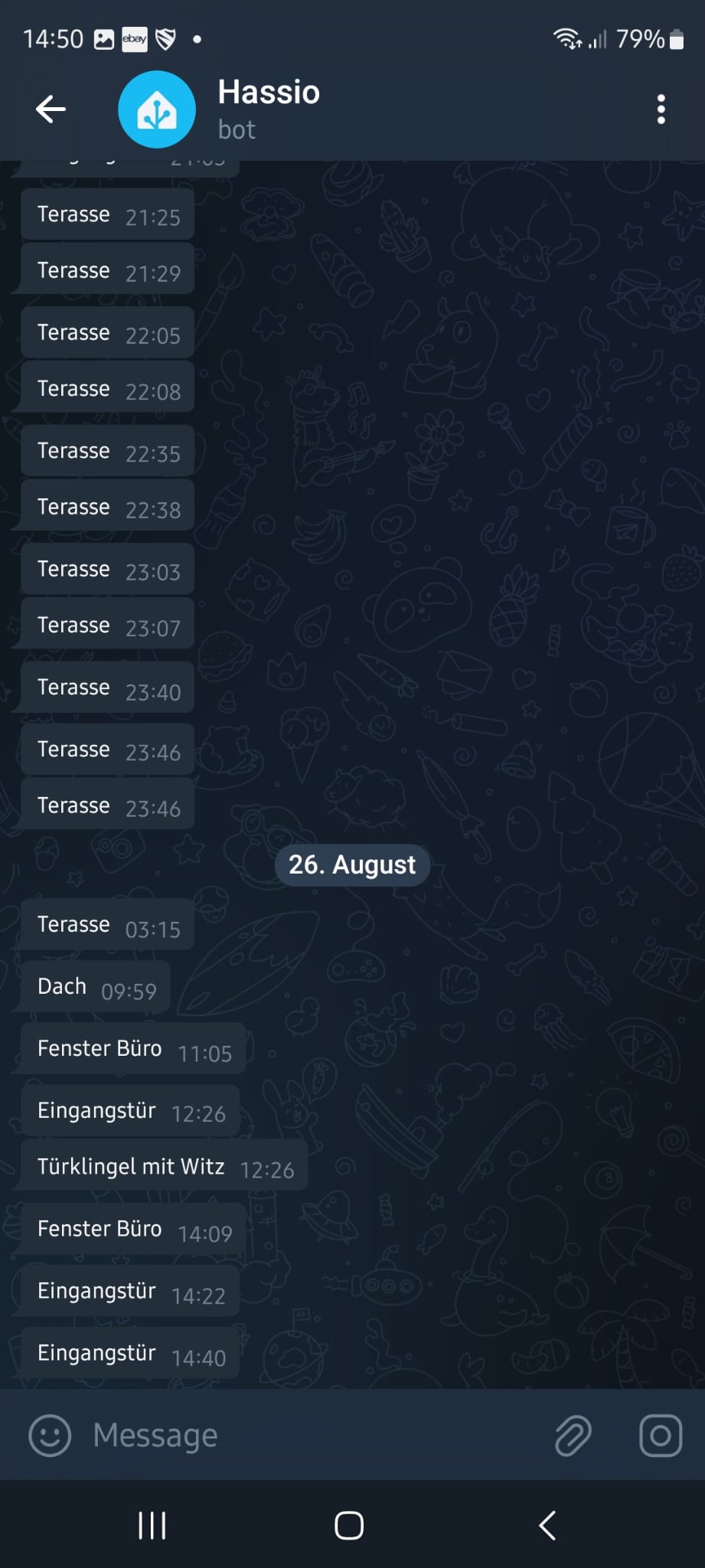

Here my Messages on Telgram, mostly worked until 0:00 oclock, on 3:15 rule with some old messages, then after restart messages come in
