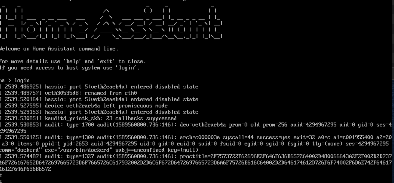

Dipping my toe in with Virtualbox for the first time. Thanks to the help above I’ve managed to get to here:
Now I’m stuck. Nothing at 10.0.1.232:8123.
What do I try next?
So I had this problem and finally figured out that you can access files in the .vdi disk file. I used 7-Zip to do this, extracted my last .tar backup, rebuilt Home Assistant and was back right where I left off in like 30 mins. Once you have this EFI booting issue it is extremely difficult to fix it. Much better to just get your last backup and start over.
