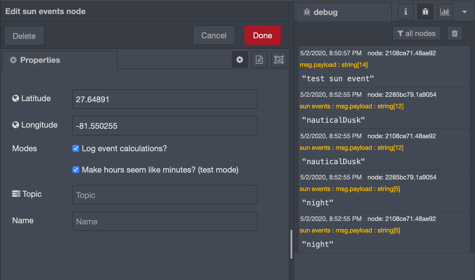

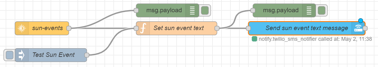

I set up a sequence to play around with NA/Node-RED. It’s pretty simple:
The JSON for these nodes is:

I get a text message when I trigger the inject node, but after almost 24 hours of having this sequence deployed, I have received no text messages and no sun events in the debug pane.
What have I done wrong or not understood here?
