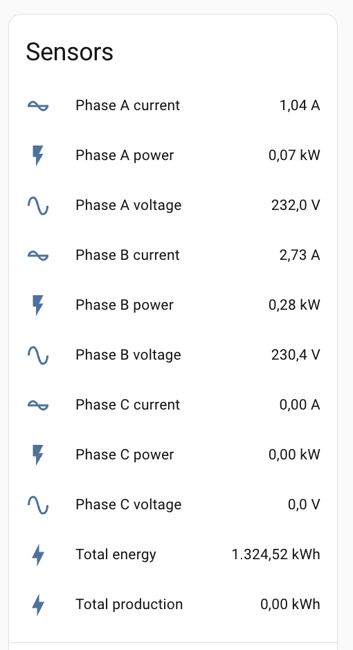

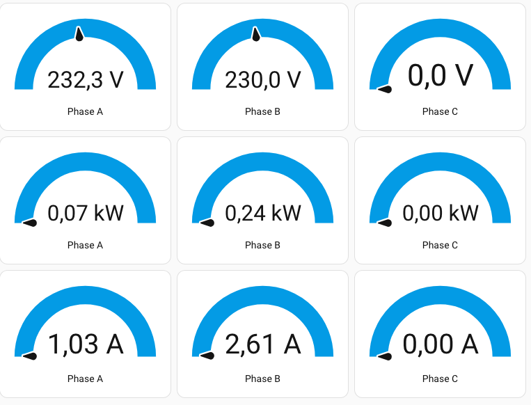

I've installed smart meter devices which measures voltage, power, and current, via tuya integration. In the dashboard I'm getting values for all entities of the device:
Historic values are there for voltage and power but not for current.
I've queryed the DB directly but the result was an empty set.
What could cause this beahvior? Is this an integration issue? How would i debug this to find the roout cause?

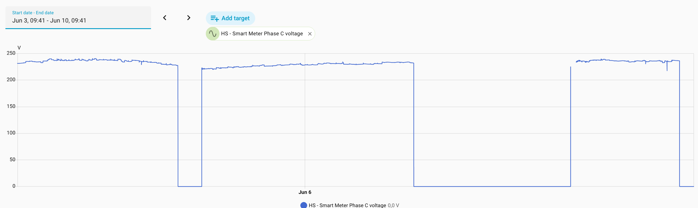

Goal: Display historical data of the entity sensor.3_phase_wifi_smart_meter_phase_c_current.
Reason: The circuit is shutting down repeatetly, and I hope to see according data.

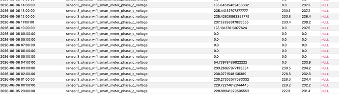

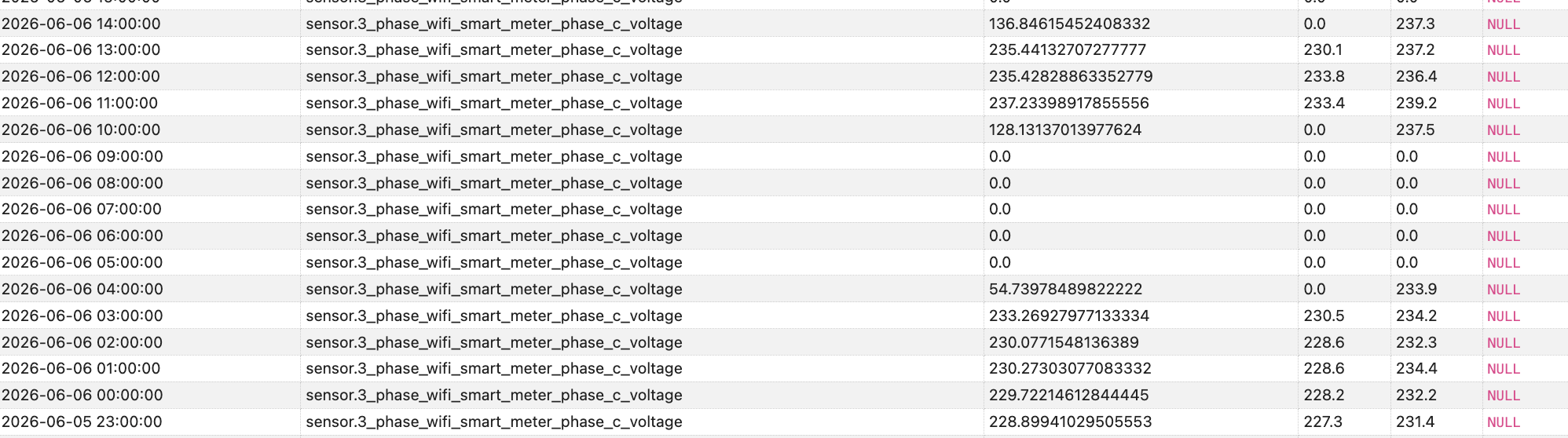

I queried the DB (SQLite Web Add-on) for another entity of the same device (voltage):
SELECT
  datetime(st.start_ts, 'unixepoch', 'localtime') AS time,
  sm.statistic_id,
  st.mean,
  st.min,
  st.max,
  st.state
FROM statistics st
JOIN statistics_meta sm ON st.metadata_id = sm.id
WHERE sm.statistic_id = 'sensor.3_phase_wifi_smart_meter_phase_c_voltage'
ORDER BY st.start_ts DESC
LIMIT 1000;
the result set was as expected (snippet):slight_smile:

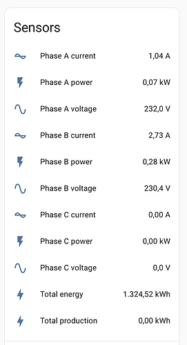

Here are all sensors, provided by the device:
All of them have history data, but the
  • Phase A current
  • Phase B current
  • Phase C current
entities
