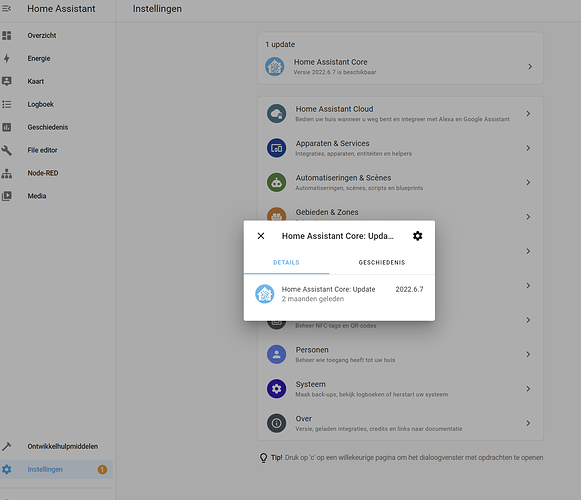

Don’t know if it’s related, but with the new settings panel i’m struggling to update home assistant. When i go to settings i see a notification of a new version. But when i click it, i just get a popup that shows me the version. But no way to start the update proces. Am i so dumb or is something not working as it should…
I was seeing the same issue and it was temporarily resolved by initially manually updating via CLI, and second time by enabling all home assistant update entities (I had a couple disabled). But I’m back at the same spot as you now, and not sure if I just need to go via CLI again for upgrading.
