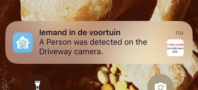

  • I receive only frigate triggered notifications on the iphone. The received image is not visible only an error message referring to:
    response status code was unacceptable 502
    clicking on it does not show any image but a link producing a 404 error.
