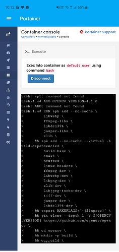

1:- Install Portainer add-on
2:- Connect to Portainer and unhide homeassistant container and exec console to get a bash session.
3:- Follow this instructions to reinstall opencv.
4:- Restart HA
@JBelinchon THANK YOU VERY MUCH! Working!

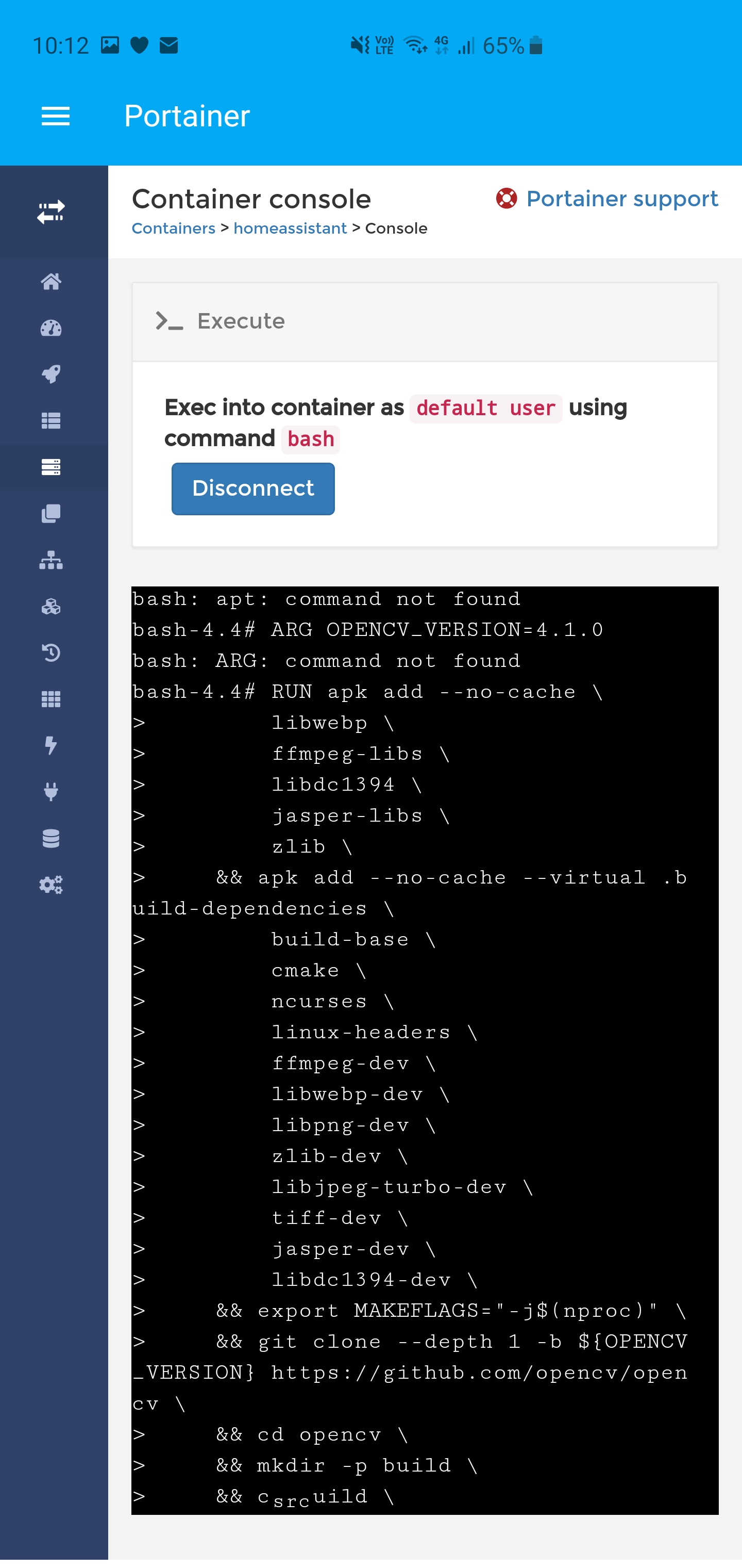

With the console, I’m not sure I did it right because I get Arg and run not found
@CountParadox, those are not a just copy / paste & forget instructions my friend.
Those are instructions for you to execute step by step knowing and understanding
what you are doing and predisposed to some of them fail and you be ready to adapt
it and continue.
If you are not retatively well acquainted with linux better not try.
On the other hand I recommend a screen a little larger than that of a mobile device.
:v:
Then they’re not instructions are they.
Instructions are to be followed, so I assumed it would be copy paste.
I’m fine with Linux but I guess I shouldn’t blindly trust people online :joy:
I’ll give it a go manually when in front of my pc
you shouldn’t blindly trust people … in general :v:
