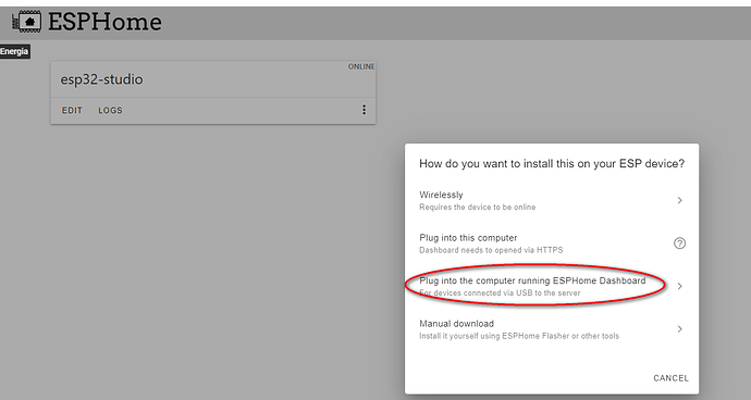

Hi.
From today when I try to update my ESP 32 configuration I can’t because don’t find serial device.
I’ve used without issue the serial device until yesterday.
Any idea?

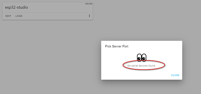

Do you have a device plugged in?
Was it noticed by the kernel? (dmesg will tell you.)
If you unplug and replug the device does the kernel notice?
What serial devices are present (ls /dev/tty*)
Hi.
Recently I changed the USB cable.
Putting the old USB cable all works fine.
Some usb cables do charge only.
