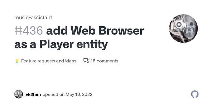

I donβt know ![]()
I made that suggestion based on a topic I found, when searching for any kind of help for you ![]()
