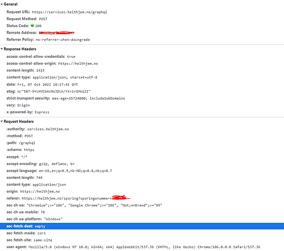

I am trying to set up a rest sensor using GraphQL for tracking my parcel. (First time using GraphQL)
I can track my parcel just using the parcelnumber on the freight website, without any login.
Headers looks like this on freight site;
payload looks like this
query:

My sensor:
rest:
- resource: "https://services.helthjem.no/graphql"
scan_interval: 3600
method: POST
payload: >-
'{"query": "{
getTracking(parcelReference: "XXXXXX") {
deliveryPoint {
postalCode
postalArea
type
__typename
events {
additionalInfoApiKey
apiKey
freightProduct
time
shipmentNumber
isHighlighted
location
messages {
message
title
additionalMessage
__typename
type
__typename
noticeData {
message
title
__typename
sender {
postalCode
postalArea
__typename
shipmentNumber
shopId
status
shop {
id
name
logoUrl
__typename
__typename
headers:
Content-Type: application/json
sensor:
- name: helt_hjem
value_template: "{{ value_json.data }}"
#data.getTracking.events[0].messages.message
json_attributes:
- "data"
I am interested in data.getTracking.events[0].messages.additionalMessage
Getting the JSON out as attribute could work as well.
