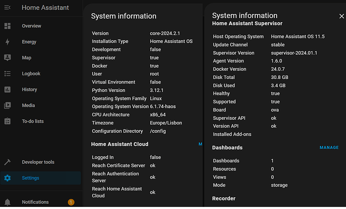

I’m a newbie who just installed HA OS 11.5 in Windows 10, running over Oracle VM Virtual Box 7.0.
I’m trying to install InfluxDB and Grafana and realised that there is no Supervisor tab, neither I’m able to see add-ons appart from three existing ones from “ESPHome”.
I’ve uploaded the system information.
I was not able to understand yet if this is a version limitation or if something is wrong (I’m confused since there is a mention to Supervisor Version).
What can I do to overcome this if not a version limitation?

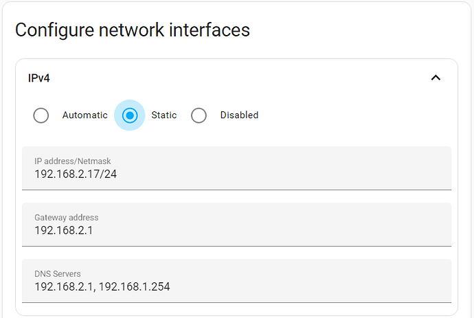

I’ve done a new install and noticed some errors.
The final result is basically the same but now I don’t get the three previous “ESPHome” addons. The addon store is completely empty.
I’ve already clean the browser cache and I’m out of ideas on how to overcome this.
Any idea for solving that?
The address at 192.168.2.1 is the one from the (DHCP) Router and the 192.168.1.254 is the default gateway and they both seem to be are OK.
The HASS is running in “Automatic” but if I switch to “Static” they are there.
