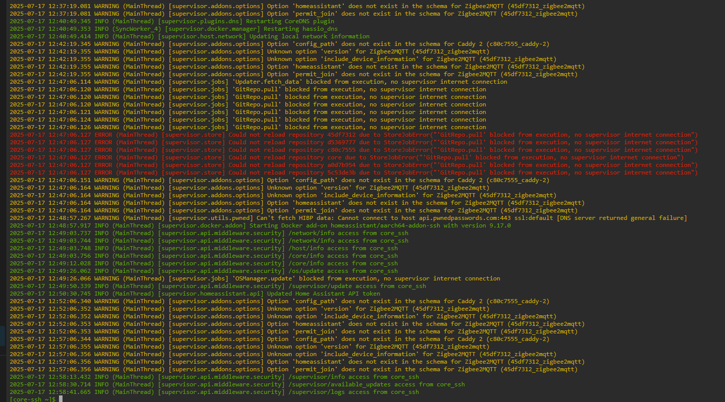

Not seeing any updates past 2024.10.2 and cannot force an update, is there something I might be missing.
Nothing showing ubviously in the UI either.

You do not have internet connection from your HA installation, or at least it is blocked on either DNS level or access to GitHub.
You need to check your router and firewall for limitations and/or what your ISP block too.
Based on the error shown in the screen shot I agree with Wally. Presumably, you also can’t add any new add-ons, or HACS components since they all require github too. Anything in the logs?
