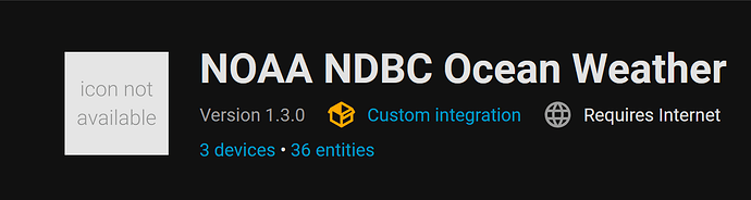

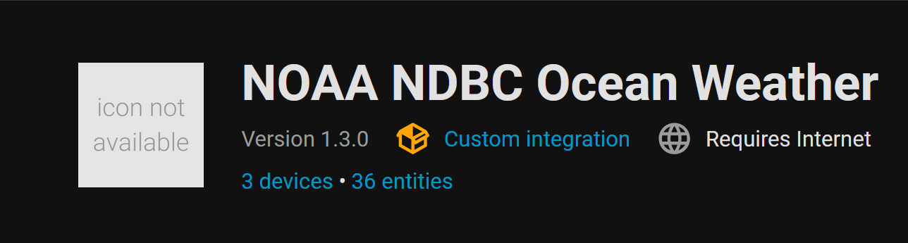

the icon for the integration does not show if installed from HACS.
