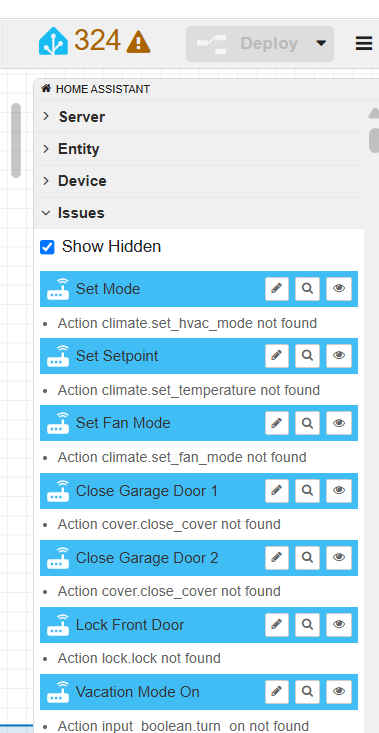

Node-RED crashing... system time change detected, entities not found in cache
I’m cleaning up my HA instance and most everything is working well except for the Node-RED app v22.0.1; Node-RED v5.0.2. I started having issues since HA 2026.8.x (1 or 2). Upon an HA system restart, everything comes back up just fine.
Here’s a successful startup log. I see some issues with some entities and nodes that I don’t entirely understand. input_boolean.pool_open is an existing entity with a valid state upon startup, so I’m not sure why that’s an issue… could not be found in cache? Also the tablet battery level entity…?
There are also some logs related to all of my cronplus nodes. Not sure why those are an issue suddenly.

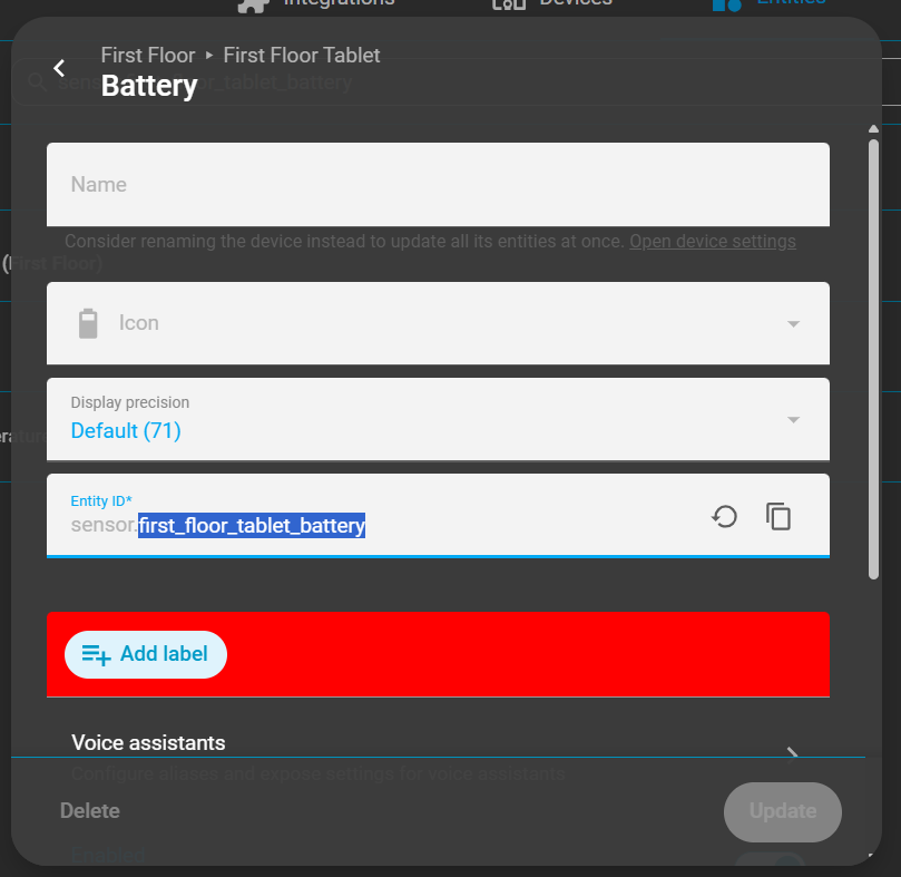

How do all of those entities look in Settings - Devices - Entities and Settings and Devices - Helpers? Are they defined in configuration.yaml or using the Helpers GUI? Make sure they all have the same entity_id’s that Node Red is referencing. I had some issues where a few Helper entities were deleted when I upgraded to 2026.8, and several were automatically renamed to include the new (forced) area entity ID format. Node Red threw quite a few errors with the missing/renamed entities.
Check your system time and make sure it’s correct. Not sure when it happened, but I’m now noticing multiple entries under Settings - System - Home Information - Region for the same time zone. I’m assuming there’s a reason for 18 different entries for -5:00 Eastern Time, but I have no idea why that’s needed. I continue to get a log entry for a time mismatch between Home Assistant and a POE camera, but both show the exact, correct times.
Make sure you only have one homeassistant server listed in Node Red - Configuration Nodes.
Thanks for looking. Good questions… first thing I checked. Most of my template sensors are defined in YAML… have been for several years. One day, I’ll move things to the UI. But, for now…
sensor.first_floor_tablet_battery is coming from Fully Kiosk. Same entity_id:
input_boolean.pool_open I set up as a helper through the UI. Same entity_id. Current value is on. I toggle this one manually twice a year.

I’ve just reloaded and gotten this:
It looks like every action node is affected. I’m inclined to think the websocket is to blame. I’ve backed up my flows… may need to take a clean slate approach here.
Edit any action or current state node and click on the pencil icon next to the homeassistance server drop-down. Make sure the “Using the Home Assistant Add-on” option is checked (assuming you’re using the Node Red Add-on app).
I am! I did a quick survey and opened 6-7 action nodes and they all have that box checked.

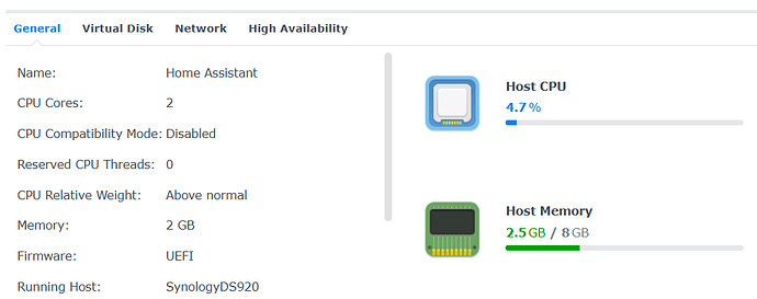

I’m running HA on a Synology VM:
I should be good for resources.
I’m going to do a backup of my flows and try some of what’s been suggested.
I don’t run a VM myself so this is a bit of a guess, but if your screenshot suggests that you have a Synology NAS with 8GB of physical memory, and you have allocated 2 GB to a VM to run Home Assistant, then I assume that you are running HA on 2GB.
As I understand the current position, Home Assistant, with lots of Apps, can struggle on 2GB.
I think you are running out of memory. Node-RED will stop if it runs out of memory (and I am sure that HA will struggle too…).
Yes, that’s correct. (8GB/2GB)… what’s a more reasonable allocation? 4GB? This is the only VM I run on this NAS. Its only purpose is network storage and HA.
Doing a little digging, and it appears I have a little over 3GB of RAM headroom with what I have now. I’ll assign 3GB to HA and see if that helps.
I didn’t consider that I could be running low on memory… but it would be a logical explanation.
I can only go by the comments made elsewhere regarding issues around running a heavy HA system on 2GB.
The HA Green I believe has 4GB. Yes you can, apparently, run HA on 2GB, but not with a lot of Apps and heavy processing (such as video work).
Every update of HA is just a little bit bigger… Around 1.5GB for HA now I believe. NR runs in quite a small space, but does need to be able to call for extra memory from the ‘system’.
Edit:
If Sir_Goodenough can’t run HA on a VM with 2GB, then I suspect you can’t either…
Great data point. I’ve just brought everything up on 3 cores/4GB (maybe a little over-allocated on the CPU) and it’s working well.
