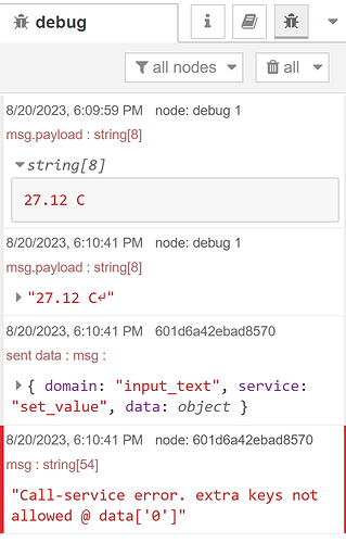

I have a simple task to read the output from a shell command, which gives me a temperature value.
Struggling how to make it a sensor input. Here is my node and the debug. Debug shows the value as it does during the command line execution, but whenever I connect call service node to input the value into an input_text field, it fails. Besides, any way to parse to value to get rid of βCβ (Celsius) and input it not to input_text but to a normal sensor value?
Try {βvalueβ:"{{payload}}"}
You can use the String Node to strip off the βCβ character as well as convert the string to a Float value.
