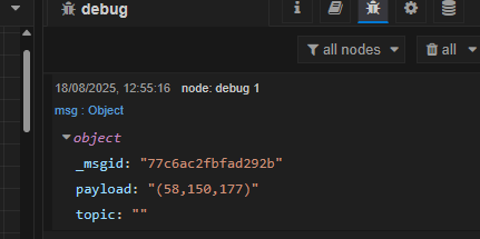

I installed this node which generates a random RGB value as a payload:

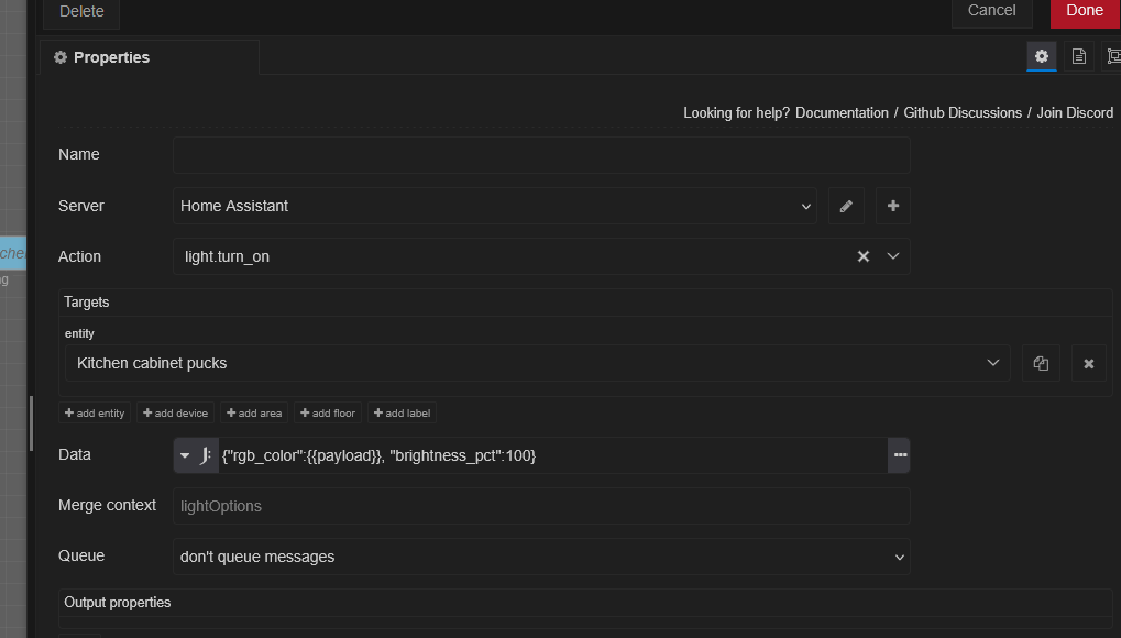

How would I then integrate that value into the light.turn_on node? What I’ve tried so far is producing JSONataErrors:

There are a couple of things here that are wrong. When passing a variable there are 2 methods. jsonata (Jexpression) and JSON {}.
With JSON you use double mustache with the path of the variable {{payload}}.
When using jsonata it is just the name of the path with no quotes or brackets, payload
You can find more information in the web socket guide under jsonata and mustache templates.
RGB color expects the values to be in an array [233, 45, 221] You are sending a string "(233, 45, 221)". I do not use that node, you can check to see if it lets specify the syntax of the output. If it doesn’t then it will need to be converted.
Yes indeed, as Mikefila says, the important thing with passing parameters to Action nodes in the Data field is to use either JSONata or mustache templates. and with the correct format. In general terms, using JSONata is to be preferred as templates do not always work when constructing JSON objects as we are doing here.

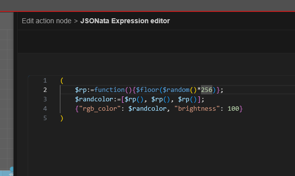

Hello. Oh thank you so much for these replies. I didn’t realise there was an expression editor on the action node so asking for help gave me that bit of new knowledge as well! I tried pasting your code, however it complained that $floor was expecting only one argument, so I changed it to this:
Seems to be working!
