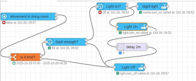

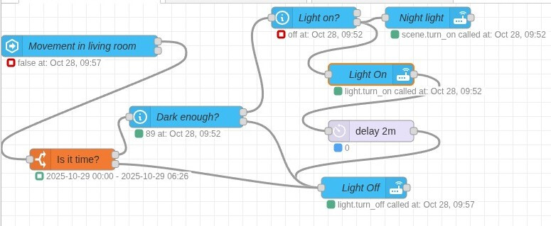

Hi @NimdaBE, I suspect you have resolved this challenge by now, but for anyone else looking - I hope this helps. :slight_smile:
This is what I am using currently, I’m sure it could be adapted for your needs with multiple timers in parallel linked in the same way as the existing one.
  1. When motion is detected
  2. If the time is between: 00:00 → dawn
  3. The motion sensor IS able to turn the light(s) ON
  4. If the time is NOT between: 00:00 → dawn
  5. The motion sensor is NOT able to turn the light(s) ON
  6. The light(s) are optionally proactively turned OFF
  7. If it is “dark enough” the lights will come ON, else they will go OFF
  8. The light(s) will come ON only if they are OFF
  9. An optional “night scene” can be triggered for the light(s) ON
  10. The light(s) will stay ON for a set time-out (two minutes in this case)
  11. The light(s) will then be turned OFF
  12. Repeat…
