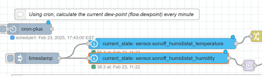

These are the two current_state nodes I’m using (to replace his singular Hubitat node that I cannot view, even after installing hubitat in Node-Red). One brings in Temp and one brings in Humidity from two HA entities.
This is the properties
when I ran a debug straight off that current_state: it shows this
and i saw at the top it said msg: Object …

You have two Current state nodes, where you can get the entity state value for the temperature and for the humidity. All (all?!) you have to do is take both values and perform a calculation on them, which is where the function node does its thing.

The Current state node - output properties
By default these nodes set two outputs, msg.payload as the entity state which in your case is “60.4” and msg.data as entity which is the entire entity object. Since, by convention, nodes usually pass the ‘working data’ using msg.payload, most nodes expect msg.payload as both input and output. But you don’t have to stick to this rule.

Had a look at the flow. When importing you should try to remove the included HA server configuration node (importing these can lead to problems) so the scrubber is a good tool to use. As I (now) know what I am doing I can hand-edit and remove the HA server node out of the import window, but the scrubber is there if you need it.
For myself, in such cases I like to step back and work out what is going on and the logic of the flow. I assume that, given an input setting of sleep/home/away the object is to set a target dewpoint based on ‘mode’, monitor the current dew-point (every so often), and adjust various HVAC settings to drive humidity to this target value.
From this I would work out what I want to control, what I need to monitor, what data flow I want, and then how to put it all together.
In Home Assistant we have ‘input’ sensors, which can be manually adjusted from the dashboard. Use the Helper to add sensors like an input number (with slider) and you have the means to set target value, or use an input selector list for ‘mode’. These input-whatever can be easily read in NR using a current state node.
In Node-RED we have ‘context’ which is memory (usually volatile) that can be used to hold values. Useful since ‘data’ only lasts as long as the flow message does. Context comes as node/flow/global and the usual one to to use is flow. These can be set and read from function nodes, but also Change nodes. Easy therefore to have a flow running that just monitors the humidity and temperature, calculates the dew point, and saves this to NR flow and/or HA (sensor). Then other flows can read this back when they need it.
HA consists of entities. These are ‘things’ and they all have ‘states’ which is the primary value we normally use. My temp-humidity device is added to HA with an integration, and this integration has created two sensors, one for temp and the other for humidity. These are read-only, and I have to read both sensors to get both values, as per out discussions above.
Simple things just have ‘states’. More complicated things have ‘attributes’. There are extra values that hold more information, and can be read but require a bit more effort, since HA is mostly setup to work with sensor.state as a single primitive value (string, number, boolean).
Climate devices - HVAC - are much more interesting, and will always have a bunch of attributes
All entities are added to HA (well, almost all) by ‘integrations’ which create the entity, manage the entity, and keep the state value updated from the real world. Along side this, some integrations will add ‘services’, now called Actions, that can be used to modify the entity. HA will not allow anything to change an entity state/attribute other than the integration that created it. The exceptions to this rule are - if you use the WebSocket nodes then Node-RED is the creating integration and you can change the state/attribute. - if you use ‘input.whatevers’ then you can add these to HA dashboard, and manually change them. - and Actions can be used to change entities, depending on the range of Actions that the integration has added for you.
For climate, therefore, your climate.home device has a state value of the mode “heat_cool” but a bunch of attributes. Some will be read only, some will be write-to.
I note that your attributes include current_temperature and current_humidity, which suggests that you could read both of these in one go. The Current state node and the Events: state node will pull the entire entity object, which includes the state and all the attributes.
In a Current state node, the default ‘output properties’ includes setting msg.data to entity and after the node (not in it) you can read msg.data.attributes.current_temperature (and humidity) and use these values directly in the function node to calculate dewpoint.
Your ‘hvac_modes’ attribute can be read as data.attributes.hvac_modes which will give you the list of possible modes (not the actual mode set - that is the entity state value).
To change this setting you need to find the Action that will permit this. Use HA Developer Tools > Actions and find “Climate.Set HVAC mode”. Once you can run the Action from HA you can use the Action node in Node-RED to do the same. Various settings you can change will be things like mode and target temperature.
How to use Actions nodes is an entire chapter in a book in itself, but you can find examples in the HA WebSocket node examples and cookbook.
