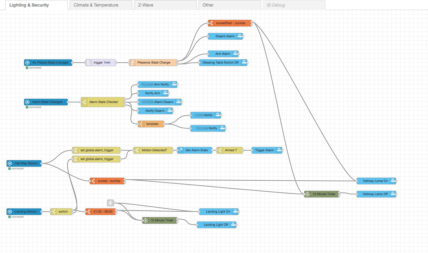

  • Arm/Disarm a Manual Alarm when group.all_people go from home to not_home and send out a notification. As the same time when disarming and it’s dark then also turn on the hallway lamp for 15mins
  • Group.all_people has to be stable for at least 1min to counteract device trackers that drop intermittently (equivalent of ‘for’ in an automation)

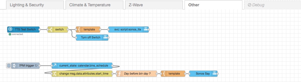

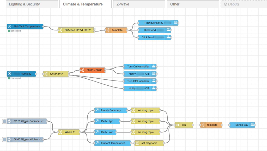

  • Take multiple sensors from the DarkSky weather integration, combine them into single message and then format them into a string that is sent as TTS to my Sonos. Providing a nice friendly message at 8am every morning
  • Use Google Calendar integration in HA to read next trash collection date, manipulate the date such that it triggers a TTS to my Sonos the evening before the trash collection date (my local authority fortunately provides an iCal for this)

In my case, I use a function node with some java script to specifically monitor state change from not_home to home and vice-versa. The function node is set-up with two outputs and the below code.
var newState = msg.data.new_state.state;
var oldState = msg.data.old_state.state;
if (oldState == "not_home" && newState == "home") {
    return [ msg, null ];
else if (oldState == "home" && newState == "not_home") {
    return [ null, msg ];
else { return [ null, null ];
If the transition is from home to not home then the first output used else it’s the second output. In addition to that, I use a trigger node in front of it to ensure the state change is stable for 1min before it triggers. This means in those situations the tracker is bouncing where it may have lost GPS or bluetooth signal etc is ignored.

@Dilby Would you mind sharing your json code for the ‘Climate and Temperature’ flow? Its exactly what I’m looking for in node-red.
Is there a specific bit you’re interested in as just had a look at that tab and there isn’t anything special in there specific to climate other than checking fish tank temperature and also reporting weather through TTS.
Hi @Dilby,
Would you mind sharing your “bin schedule” flow? I would like to do something very similar.
