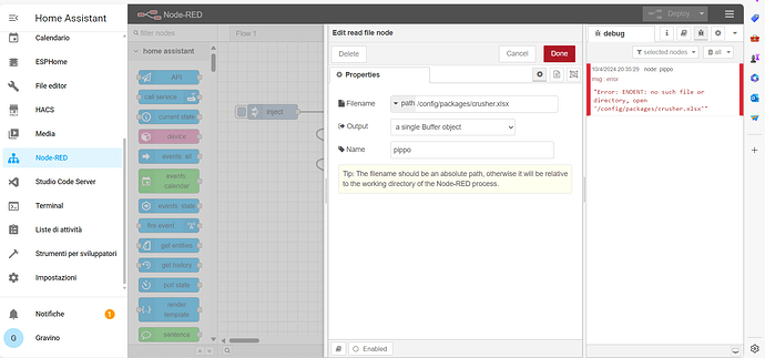

i wanted to use node red spreadsheet to read excel file i tried this
but get this error…i wuld like to hve some help
thank you to every one
hello every one,
Check your file path and spelling. The error is telling you NR can’t find the file.
with samba i copied the file inside packages, after that i past the path and copy in the node…i really new of home assistant and node red
Then that path is not accessible in node red with out adding a share for it. Do you have your media folder setup? put the file there.
