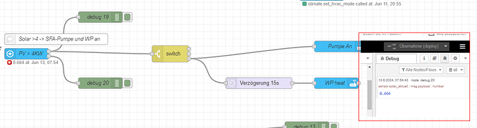

i ve here a node which will not work.
Target: Value of (1) > 4 then switch (2) my devices (3) and (4) on…
but nothing happens

"id": "1a285f1eb0c2b965",
"type": "server-state-changed",
"z": "1e52fae11f98d038",
"name": "PV > 4KW",
"server": "259ff3e1.05aa4c",
"version": 5,
"outputs": 2,
"exposeAsEntityConfig": "",
"entityId": "sensor.solar_aktuell",
"entityIdType": "exact",
"outputInitially": false,
"stateType": "num",
"ifState": "4",
"ifStateType": "num",
"ifStateOperator": "gt",
"outputOnlyOnStateChange": true,
"for": "30",
"forType": "num",
"forUnits": "seconds",
"ignorePrevStateNull": false,
"ignorePrevStateUnknown": false,
"ignorePrevStateUnavailable": false,
"ignoreCurrentStateUnknown": false,
"ignoreCurrentStateUnavailable": false,
"outputProperties": [
"property": "payload",
"propertyType": "msg",
"value": "",
"valueType": "entityState"
"property": "data",
"value": "",
"valueType": "eventData"
"property": "topic",
"value": "",
"valueType": "triggerId"
"x": 200,
"y": 240,
"wires": [
"520aa8846286d6d8"
"id": "520aa8846286d6d8",
"type": "switch",
"name": "",
"rules": [
"t": "eq",
"v": "on",
"vt": "str"
"t": "eq",
"v": "off",
"vt": "str"
"t": "jsonata_exp",
"v": "{\"hvac_mode\": \"heat\"}",
"vt": "jsonata"
"checkall": "true",
"repair": false,
"outputs": 3,
"x": 590,
"y": 240,
"wires": [
"df9fe8716d57acfe"
"1d4f76236d5251c3"
