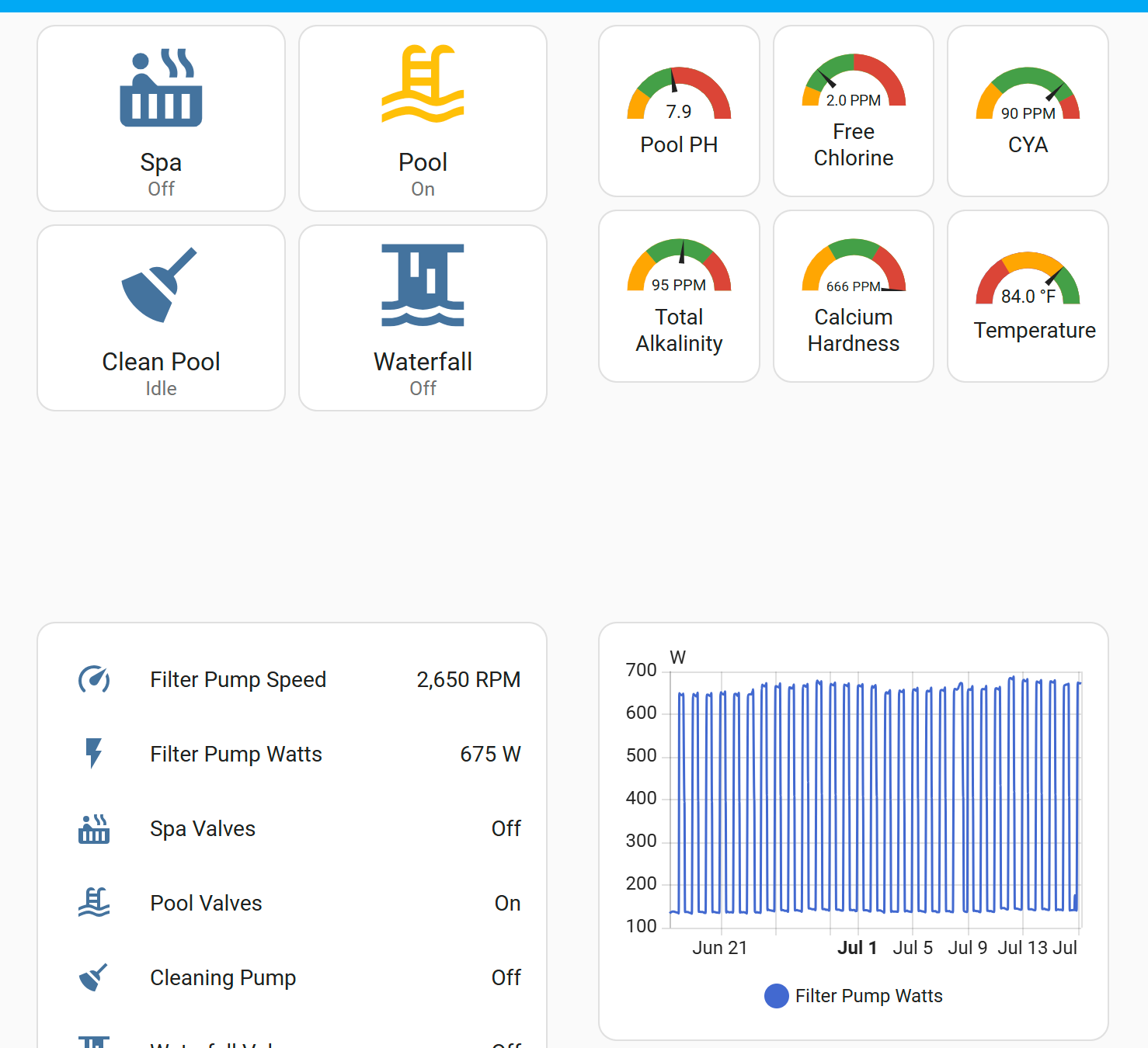

@Crewski thanks for this excellent integration! Here’s the dashboard I created using this integration.

Here’s a pic of one of my dashboards just for fun :slight_smile:
