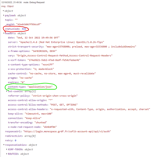

Hi everybody,
I need some help with node-red and the “http request” component.
I try to use some API but I get only http error 415 whereas I set up the headers.
I follow this steps on NodeRed doc : Set a request header : Node-RED but it’s not working I don’t uderstand why I get this message …
Is there somebody who can help me with a tutorial or a track to follow ?
You might also need to send a header of Accept: application/json.
HTTP headers are supposed to be case insensitive, but given it’s normally expressed as ‘Content-Type’, so that also might be worth trying.

Thanks for your code I add a function to set this and it’s seems to change something because now I get an 500 error while I used to have 415 error
So I have to find why this now.
Thank you !
